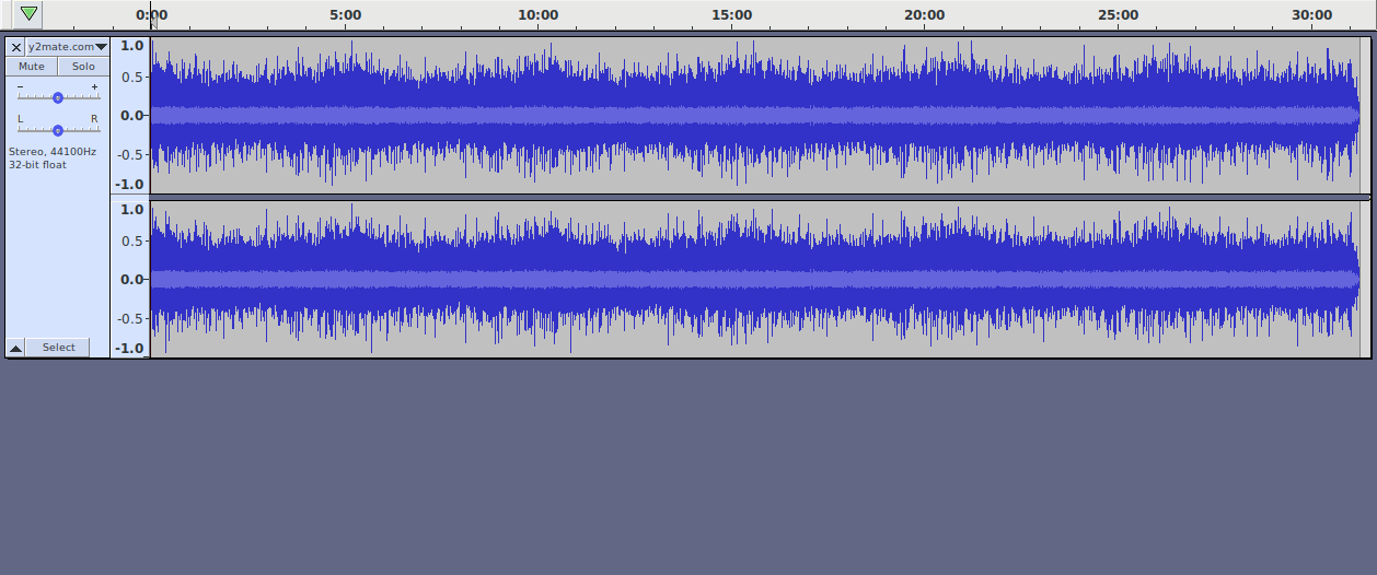

When I use the above script on this track:
I get this output:

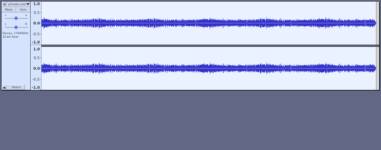

When I use this code, I get a completely different output from the Edgar’s code, which is shown below
You can notice how different this is from the output from the Edgar’s code.
I think the output from this code is similar to the output one would get if they followed the method of creation mentioned in the patent.
