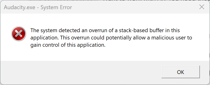

And I’ve also just gotten this error:
Did it work in your previous version of Audacity? If it did, then it may be worth going back to that version.
Let us know if it works in an old version, as that would indicate a bug in the current version that needs to be logged and fixed.

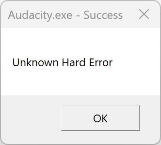

Still playing around with this. Still having problems and seeing Audacity crashing:
I’ve been using Audacity for around 15 years or so and I haven’t seen it crash like this in ages. No doubt that is simply a reflection of the automation code being knew and not getting as much use as the core functionality of the codebase. I’m still not seeing any sort of clear pattern in what I’m doing that might shed some light on the root cause of the problems.
