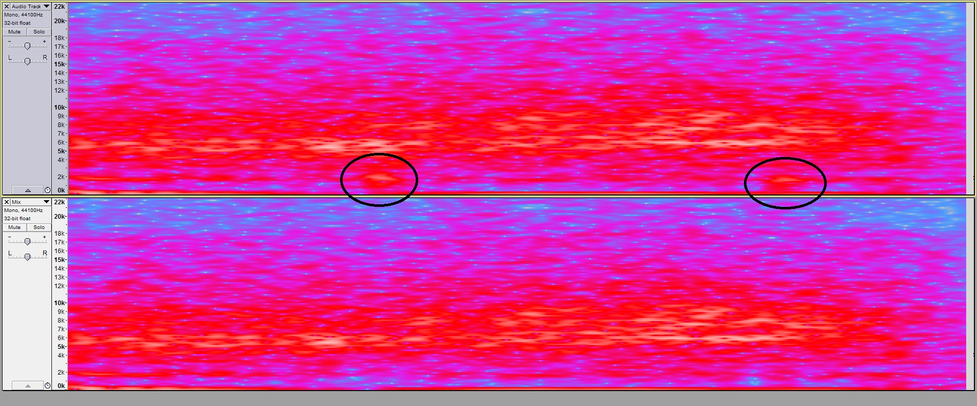

Here’s one example of the fixes I can do. Above, an “s” sound with two hot spots around 2kHz, which sound like little bumps when you listen closely. They are a distraction of the sort I sometimes snip out by hand.
Below, the same after applying fixes with the default setting. In context it is now a smooth sound without the distracting bumps.
This demostrates that not all clicks I want to remove are for lowpass filtering.

“Clicks” can be bumps in low frequencies too. I made the picture above. Another sort of distraction in even lower frequencies (like 250-750 Hz) is what I call the “implosive” smacking of lips together that you can hear sometimes in “sm” or “sp” combinations. My tool can highlight those too, but I have not (yet) found good repair settings for those flaws.
