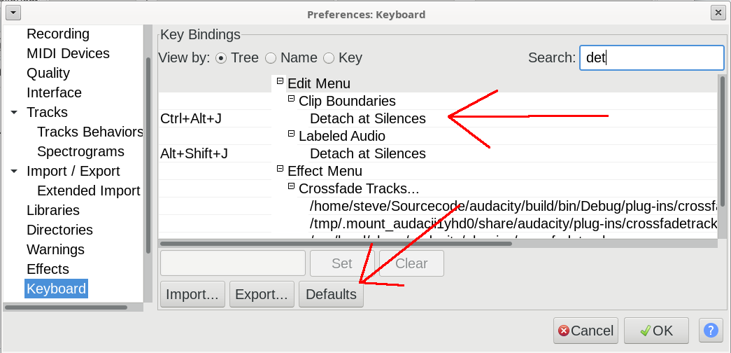

Here’s the confusion (for me). There are two “Detach at Silences” Edit menu options. One is for labelled tracks and it’s found under “Edit → Labeled Audio → Detach at Silences”. That one is mapped to Alt+Shift+J. The other one is under “Edit → Clip Boundaries → Detach at Silences”. The latter has no keyboard binding by default, even though it’s the one that’s easier to use.
