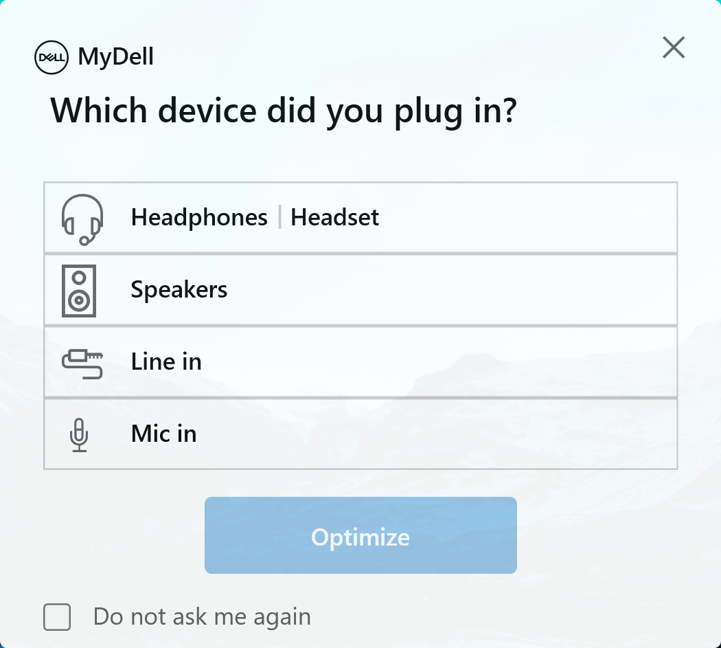

I’m trying to use Audacity 3.7.3 to record audio using the line in on my Dell XPS 16 laptop but no matter what combinations of host and recording device I try I get either a -9999 or -9996 error either invalid host or recording device not recognised. When I plug the line in device in to the port on the laptop I get a popup asking what device I just plugged in so I select line in and then start up Audacity. Even after selecting ‘rescan audio devices’ in the Transport menu I get the error as soon as I click on the record button. This is driving me mad especially when on my old Dell XPS 15 it just works. Any advice will be greatly appreciated. Details of audio devices on the laptop are listed below

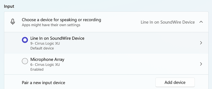

Just a bit more on this, it sure looks like this laptop has a line in
That’s what I see when I plug the jack in and I select Line In
I then start Audacity and rescan audio devices and it looks like it has recognised a line in input
Windows seems to think there is a line in
The allow/don’t allow toggle is confusing, but when it says Don’t allow clicking the button turns the input off
Maybe I’m just barking up the wrong tree but if this laptop doesn’t have a line in it is making a good job of pretending that it does
