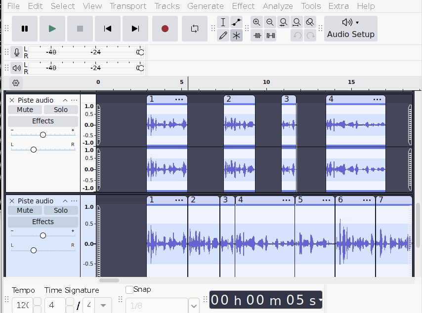

Hi, I would like to thank @Darrren for this attempt, I will say attempt because on my side with audacity snap 3.7.5, we have First track is original, second after calling his plugin….LOOPHOLES that can be detected if we add label name on each clip. I have 310 clips on board.. clip 245 destroyed and after many others ones…seems ther is loophole somewher in the algorithm or memory corruption 4go tmpfs for project file 830 Mo ←- wil check this side?
plugin_empy_gaps__buggy
same result with 9go tmpfs…with faster computer. if I select a bunch of problematic clips ones only , delete gaps works on them so there is a problem of memory when too much clips are selected. This is my case, I selected the track so al the 310 clips at once and it started to corrupt at clip 245..
I tested with 100 clips, and your test of 300+ clips is more than I expected. :hushed_face:
Have you tried selecting the clips in groups of 100 to 200 clips total? Using this plugin for three groups of 100+ clips might allow it to work as it should.
Yes by group of less it works, this what I finish to do having no solution
maybe a variable or memory limitation somewhere.. difficult to track what is
happening in nyquist world..
@Darren : Tested with a project that has 231 clips: NO PROBLEMO.
That’s great! Maybe the threshold is near 256 clips, due to a byte size issue.
