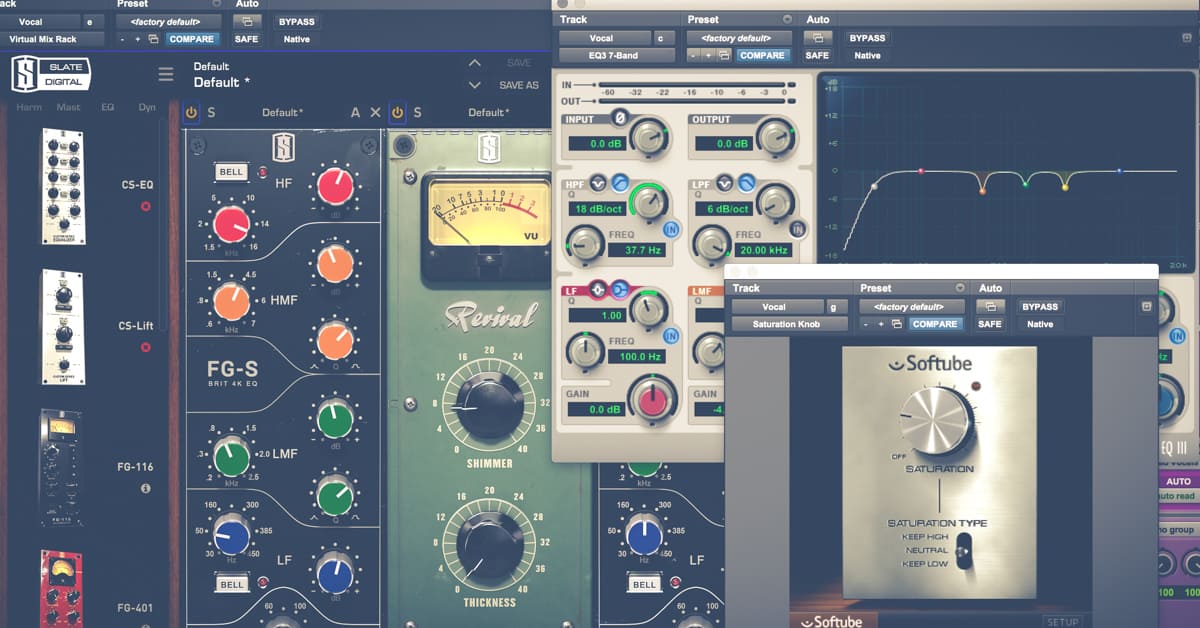

According to this article , their 8 Steps supposely I should do , I never do any of them LOL.
Editing
EQ
Compression
De’Essing
Limiting
Reverb and Delay
Automation
Creative Effects

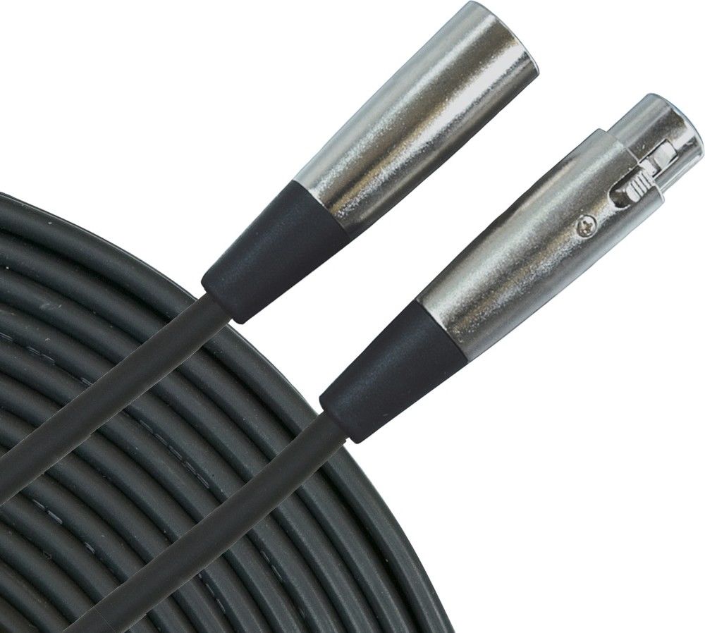

OK , My AKG is using theses
The MALE XRL is from Musician’s Friends ,
and then that FEMALE End was a cheap china one.
Which I had to RESOLDER the wires , It worked great afterwards and now it’s back to crap ,
So I think my real issue is
time to BUY a real FEMALE END PLUG ,
Perhaps male too. As I think me pulling out is what ruined the inside wires.

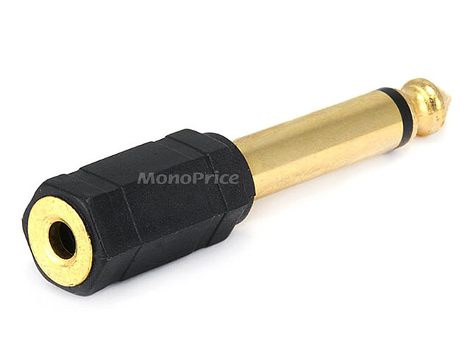

This is the formula if you want to mess with it more.
The 1/8" adapter is wired the same as the 1/4" adapter. Yes XLR 1 and 3 are twisted together and become the 1/4" shield. Pin 2 becomes the 1/4" tip.
DO NOT buy a cable where the 1/4" plug has two black rings as in that pix.

Depending on how they wired it, yes. Male XLR has the music on it. The Female XLR is where you put the music. So that one is backwards.
If you’re an animal, putting too many adapters together isn’t a good idea, either. One tug in the wrong direction and somebody will be taking the adapter (or amp) apart to fix the cracked internal contacts.
That pix up the thread with female XLR and one-ring 1/4" male looks to be perfect.

So I was digging in my box ,
If I was to put the BIG 2 RING into the Small 2 RING and end it with the BIG MONO ,
Would that help cancel out that GROUND Line you talked about ?
I can’t tell. There’s too many connectors and adapters.
As if it wasn’t bad enough, if you throw enough connectors and adapters in there, the chances of having a bad, hummy or ratty connection go way up. You’ve met this. This is when your sound is a little buzzy and it goes away instantly when you touch or wiggle the plug. And then next Wednesday it comes back.
The home style plugs have the metal surfaces right out where you can touch them and get your finger oils all over everything. The Pro/Broadcast XLR connectors have the gold or silver pins buried inside the metal shell where they’re hard to get to. That’s not an accident.
We’re not cancelling out the ground.
The XLR connection has your voice between pins two and three. Full Stop. There’s a shield (that’s the metal braid around the cable) and that’s on pin one, but it has nothing to do with the sound.
The pins are usually labeled inside. Take a strong light to the connector and you can see them.
Scene shifts forward to the 1/4" plug. The voice is between the tip and ground.
Suddenly the ground is part of the show and really important. There are expensive, fancy ways to adapt between those two systems, but the home user can usually make do by jamming both XLR pin 1 and XLR pin 3 into 1/4" ground. XLR pin 2 goes to the tip.
Get there any way you want and use the fewest connections and adapters.
This isn’t rocket surgery as long as you know what the rules are.
I bet you’re wondering why everybody doesn’t do it this way.
Scene shifts to a live concert. The performer microphones are on stage, but the show mixer could be half-way up the audience or in a mix truck at the loading dock a hundred feet away. That only works when there’s a perfect XLR at both ends of the cable. No adapters. Zero.
So you can take the XLR apart and see where the cable colors are soldered. Take the 1/4" apart, trim the damaged wire and follow that recipe.
