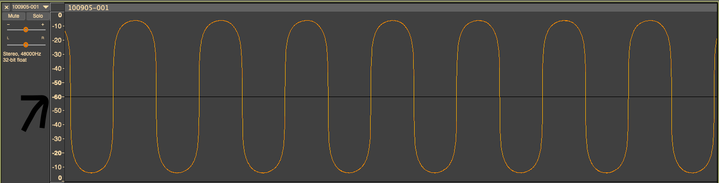

When I switch the scale on a sound file from “linear” to “dB”, I noticed something. The scale uses -60 dB as its zero, why is that?
I am doing my High school diploma project and this would be useful to know. I will insert a picture, please take a look at it so you understand what I mean :slight_smile:

As dB is a logarithmic scale, the zero point for it is at -inf, and it’s very difficult to build a thing with evenly spaced ticks which goes all the way to negative infinity. Impossible, really.
For audio purposes, -60dB (or 0.001 amplitude) typically is where useful information ends, anything quieter than it tends to be just noise. Having it stop there is just convention though; you can change it in Preferences → Interface → Meter dB range.

Also, note here that it is a negative number. 0 is a point at which, once the sound is louder, the peak (or trough) will start clipping.
-10 means you could, ostensibly, increase the volume by 10 more decibels before you will start to hear distortion.
-60 is VERY quiet. But -INF would be what you’re thinking of as “Zero” in this case, (or absolute silence.)
In this scale, zero is actually MAX volume (without clipping or distortion.)
