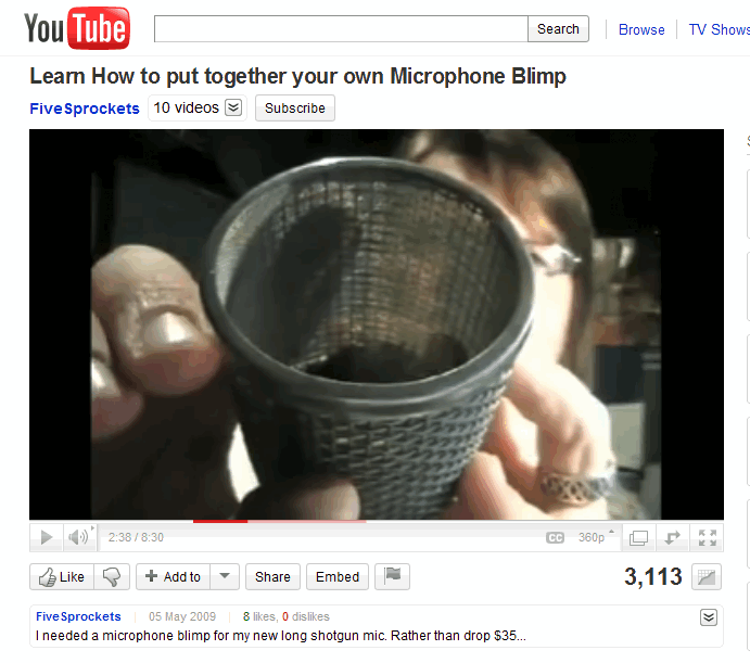

You need to maintain an air gap between the fur and the mic with a cage of some sort, the mesh size makes a difference …
http://www.youtube.com/watch?v=WW4Gj1RnM2c

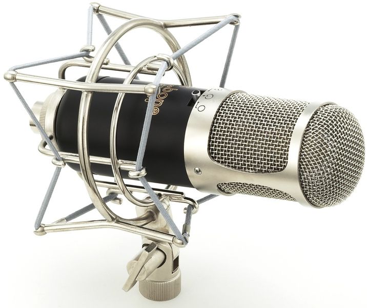

My mic looks like this: http://images.thomann.de/pics/bdb/156824/3445308_800.jpg
It already has a lot of air gap inside the mic case (mesh case like in the video), do you think I still need to add some more extra space to that?

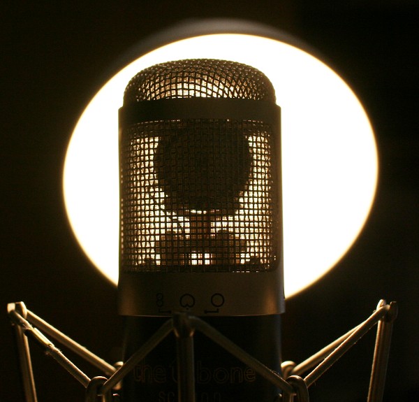

The mic has two metallic meshes, but not foam. The outter mesh is wider and the inner mesh is thinner. See pics below:

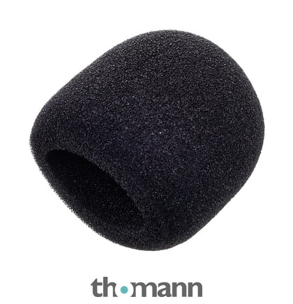

I meant one of those optional removable foam covers …
Thomann’s reply was that they didn’t have any windshield for large diaphragm mics, so I assumed none of those would fit my mic…
That in particular states 40-50mm diameter mics. Mine is nearly 60mm diameter. Still not sure if that would fit… Anyways next time I have an opportunity to record outdoors I’ll try with the sock only and see if that’s enough :slight_smile: I’ll keep you posted!

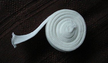

(tube) gauze bandage has a very open weave, (acoustically transparent ?) …

I have some gauze bandage I can try, but it might be too much open weave for stopping the wind.
