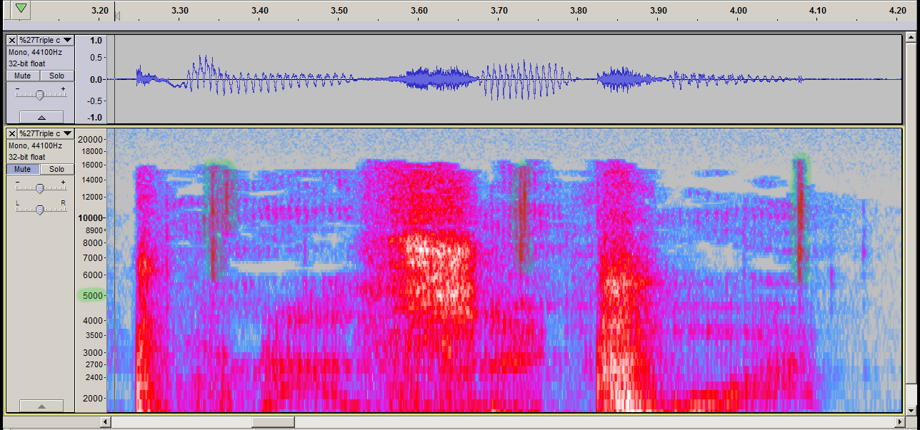

I’ve tried the click removal feature in Audacity, but depending on settings it does not find them, or degrades the audio. The clicks are so tiny, but in some sections so many.
Is there some way to create some kind of custom filter or process that targets just these tiny clicks?
There is a free DeClicker plugin for Audacity which will automatically remove clicks, here.
Now the bad news, that plugin is slow: at the settings required, (shown above), processing-time is about double the playback-time , (on my computer, YMMV). Also that plugin may choke on audio which is hours long, you’ll have to apply it in installments, (Try 15 minute chunks, then see if you can get away with longer sections).

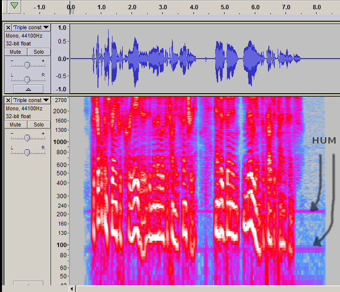

The code below if put into Nyquist prompt removes the mains-hum, (no effect on clicks)
That’s 60Hz mains-hum and some other constant low-frequency signals, (and combinations thereof).
You can get rid of them with the notch-filter code shown in my previous post.
Paste the code into Audacity’s Nyquist Prompt, (which is in the effects menu),
then apply Nyquist Prompt to the Audio like any other Audacity effect.
If you still hear rumble after removing the hum, try this “100Hz rumble” filter in Audacity’s equalizer.

You changed three things from the defaults - interesting, could you say your thinking?
Step size changed from 5 ms to 3 ms.
Minimum time between clicks (steps) changed from 3 to 2.
Test frequency minimum changed from 150 Hz to 5000 Hz.
You’ve also changed the test frequency maximum from 9600 to 15000, but think I understand that: although few can hear above 9600, why not be thorough, since high frequencies don’t take as much computing time as low frequencies.

You could DeClick the entire audio spectrum, 20Hz-20000Hz , but with that plugin, set at 3ms steps, processing-time would be tens of times the playback-time.
You can increase the maximum from 15000Hz to the full 16000 Hz, there will be an increase in processing time, but I don’t think anyone will be able to hear any improvement.

I found the “Isolate” option very useful to see what it was going to remove, convincing me the settings you provide work great, without taking out too much.
