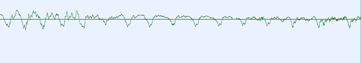

There’s a “crunchy” sound in voice over (closest description is a chip bag??) that I’m unable to diagnose or fix. The problem seems to be (??) the ugly looking waveforms that get jagged and dense (my attempt at technical language) relative to the surrounding ones. I have tried messing with these by cutting repairing, or deamping, which might diminish the sound a bit, but doesn’t remove.

A few seconds of the sound or a spectrogram would be more useful than the waveform.
Yikes. Sorry. Didn’t mean to be tedious. Even knowing that the waveform itself is useless for diagnosis is helpful, so thank you for that. Here’s audio. You can hear it right in the first second, and the rest is clean. Thanks!
