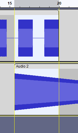

OK, let say you have two tracks, 20 and 15 seconds long, respectively. You do Align End-To-End and you now have exactly 35 seconds of audio. Now you want, say, a 4.5 second overlap. We know exactly where the first track ends by selecting it and looking in the selection toolbar at the bottom of the screen, which in this case is 20. So we manually compute 20-4.5 = 15.5. Select the second track then Extras > Scriptables I > Set Clip > Start: 55. Make sure that the Start box is checked and the others are not and click OK. Now just swipe the audio with the cursor.

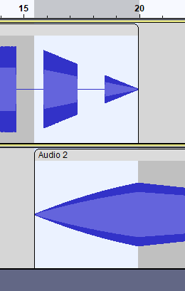

Now Edit > Fading > Crossfade Tracks:

That is a typo. Unfortunately, I am not a great proofreader. SB 15.5. Also, “Effect”, not “Edit”. ![]()
