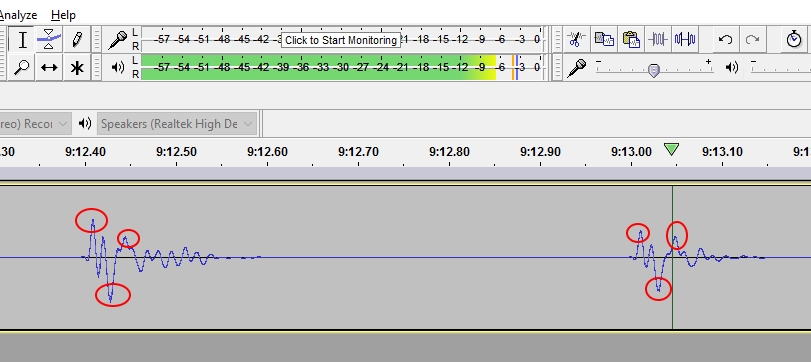

Working on that now - will come back with it. A JPG of a single offending drum hit will explain it far better than words - it will show the initial transient used to open the gate (and provide the initial sample trigger) followed by another trasient a few milliseconds later (sometimes just as high in amplitude, if not higher) that’s causing the offending/unwanted re-trigger.

I’ve attached some file here
Screenshot of a couple of kick drum hits
A zoomed in single kick drum hit

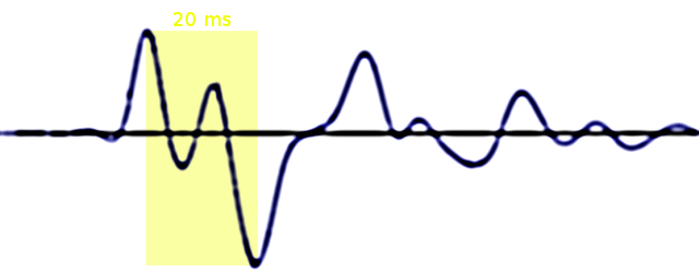

This pattern is consistent …
So you could set the threshold to use the largest peak as the trigger, then time-shift the track backwards by 20ms.
[ I don’t think you’ll actually notice a difference after 20ms time-shift ].
Differentiating using “slope” also creates the biggest peak where you want it, without having to time-shift …
