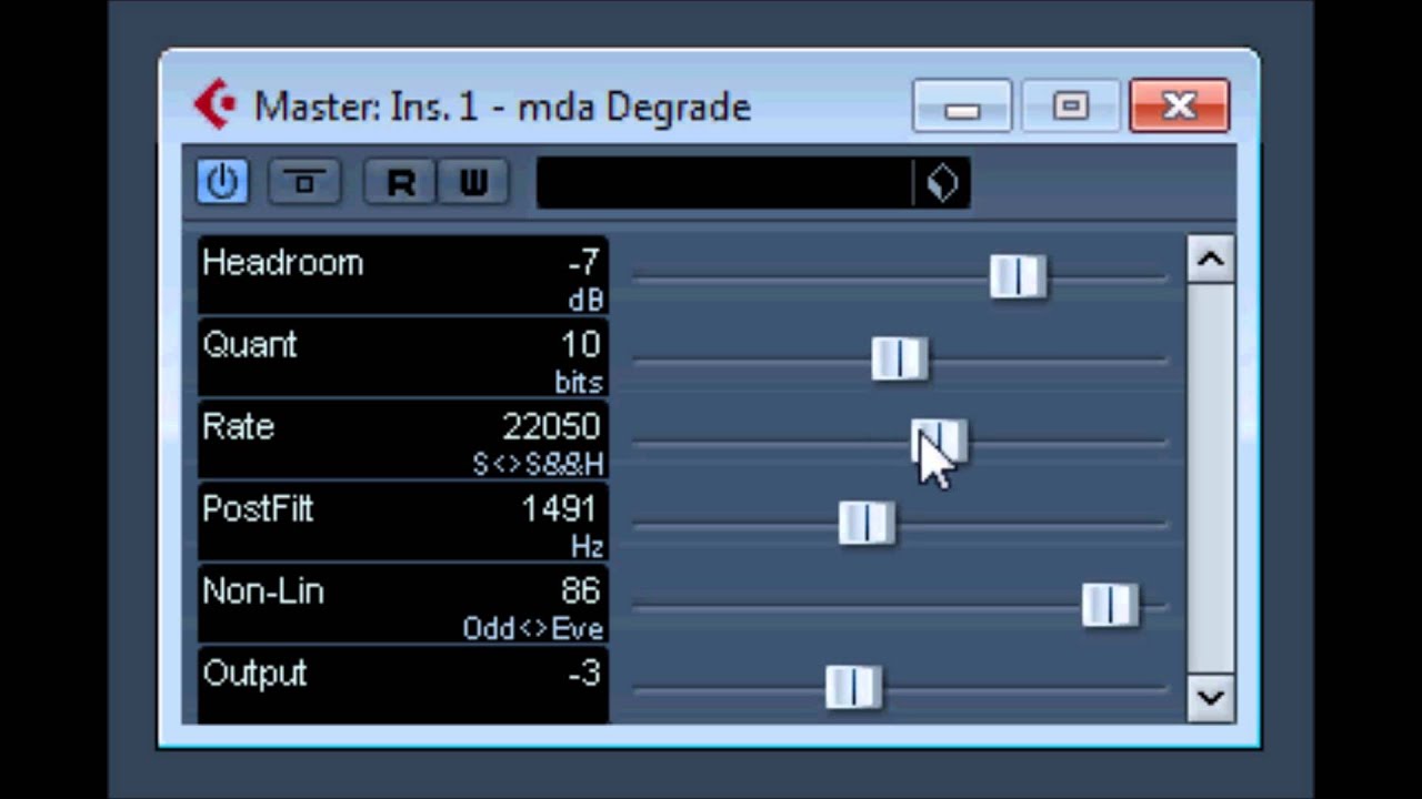

Can downsample & lower bit-depth to make existing sound like retro computer game.
e.g. with free plugins like DBlueCrush or MDA Degrade
What sort of “retro” game are you referring to, exactly?
The degradation is variable: adjust to taste …
I checked the second video, which brought me to http://mda.smartelectronix.com/ and its VST plugins. Problem is, they keep crashing/closing Audacity when I use them. Specifically the Degrader.
