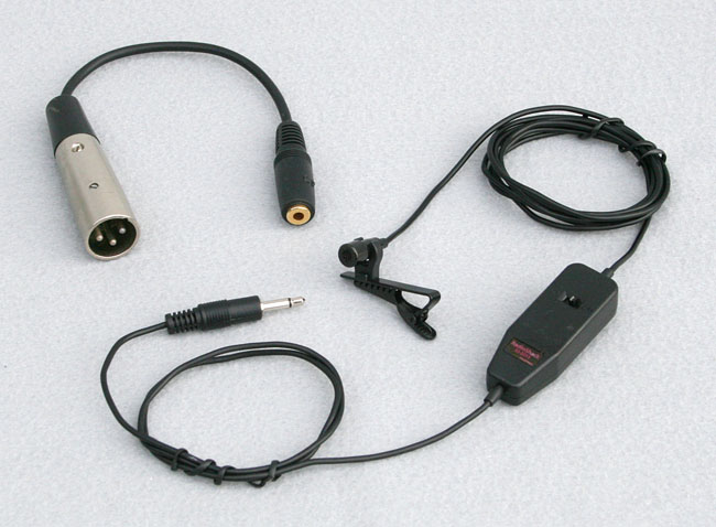

This is a lavalier microphone. (ignore the adapter cable on top)
That’s a Radio Shack, believe it or not. A 3013 tie tack microphone (from memory).
A different but similar microphone.
Full stop. That’s assuming your camcorder has no provision to plug in a separate microphone. If it does, then the separate sound recorder can go away.

You can see these microphones on any TV news show and even some of the video podcasts.
