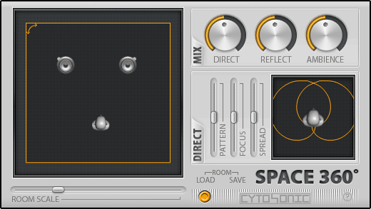

There are free room-simulation VST plug-ins which work in Audacity on Windows, e.g. …
