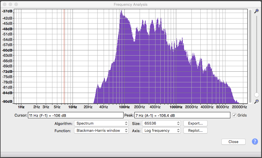

Here’s a simple mono voice track (mine) in Analyze > Plot Spectrum. Note the “size” of the analysis is quite a bit higher than you would normally use for speech. You might think that would limit your presentation duration, but as I’ve posted before, subliminal doesn’t lend itself to multiple pages of affirmations. It’s “Stop Smoking,” not “Stop Smoking, Page One…”

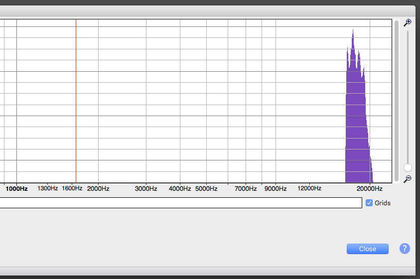

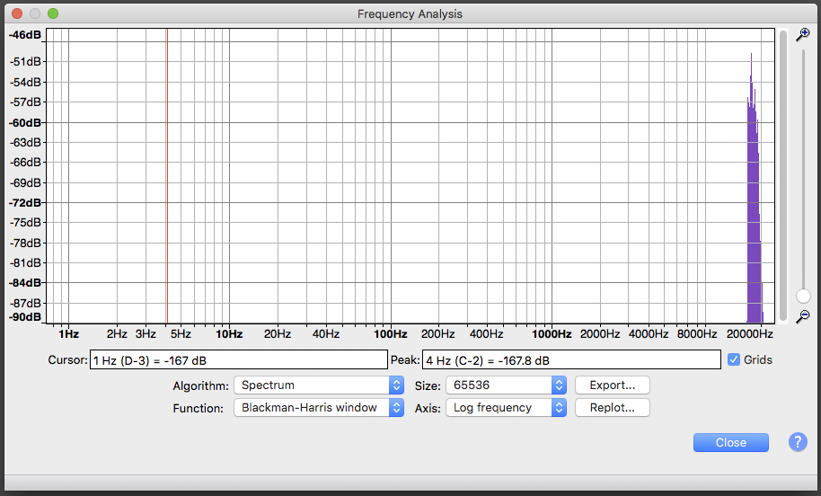

This display is of the Lowery ultrasonic sidebands. Yes, it’s hard to see, crammed into the right like that.
I artificially magnified the display to make it clear the energy goes from 16,000Hz, the former carrier to just shy of 20,000Hz, the limit of most sound systems.
