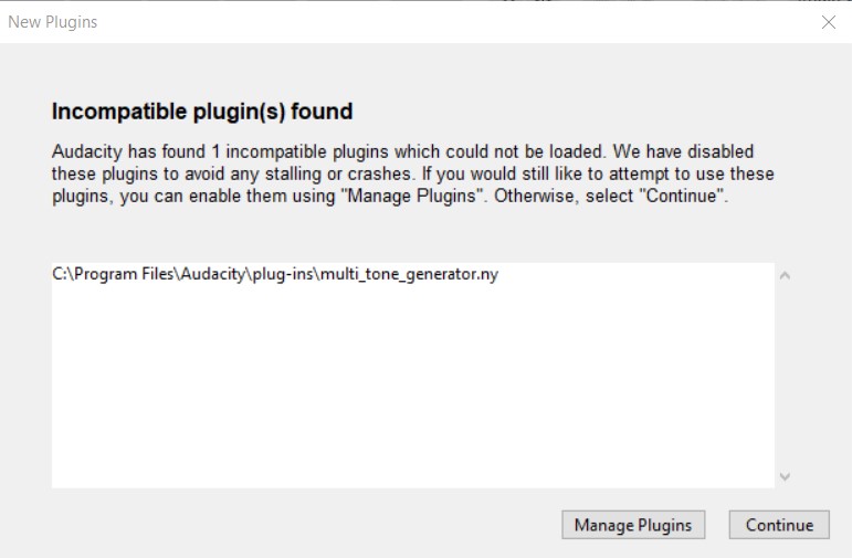

The code I posted is a “Nyquist Script”. Use the “Nyquist Prompt” to run it: Nyquist Prompt - Audacity Manual
The script could be modified to make it into an installable plug-in by adding the required plug-in headers, and then installing the plug-in using the Nyquist Plugin Installer.
Thank you, Mr. Steve. I was able to get the code working.
