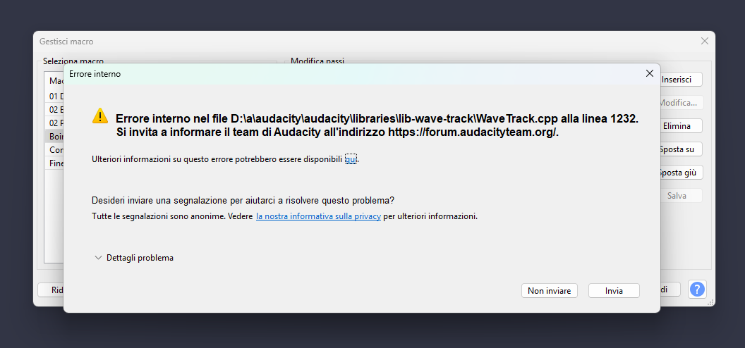

Crash: Internal error WaveTrack.cpp:1232 when a Macro runs a generator right after creating the first audio track (Audacity 3.7.5, Windows 11 Pro)

Actual
Notes
  • If there is already at least one audio track in the project BEFORE applying the macro, no crash occurs.
  • The crash also occurs when using Chirp or Pizzicato/Pluck instead of Tone.
  • Adding SetTrackStatus: Focused="1" Selected="1" and/or priming with Silence does not avoid the crash when the first audio track is created and a generator is executed within the same macro.
  • Looks like the first WaveTrack is not fully initialised before the generator writes data.

Thanks @KainTS , this is a perfect bug report. I created an issue in the bug tracker: Error when applying a macro · Issue #9210 · audacity/audacity · GitHub
