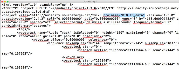

Right Click the AUP file > Open With Text Edit on Macs, or Notepad in Windows. DO NOT SAVE ANYTHING!
I know it’s a mess, but there is an entry (in blue here) which reflects the original show name. Click on this image for a larger view.
See projname=“BTO TJ_data”?
BTO TJ_data is the data folder name, BTO TJ is the original show
name and BTO TJ.aup is the Project Name.
If you have both the aup file and the _data folder and have them in the same folder or location, it should be possible to rename them to the original name, double-click on the aup file and the show should open.
I would personally do all these tricks to COPIES of these files, not the originals.
Yes, they both have to be in the same place. The AUP file will not go looking for the _DATA folder.
Yes, you do need the _DATA folder. The AUP file is instructions that tell Audacity what to do with all those tiny sound files in the _DATA folder.
