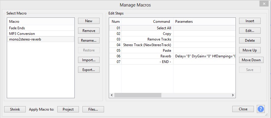

So I went to the Macro Manager to create my own steps which are:
Open File, Select All, Duplicate, Make Stereo Track, Effect/Reverb, Export as .ogg, close.
I cannot find ‘Make Stereo Track’ in the Macro Manager. Workarounds, such as Select All, Copy, Remove Track, New Stereo Track, etc. do not seem to be available either.
And finally, can I export back to the same folder that the file was located and replace the existing file?

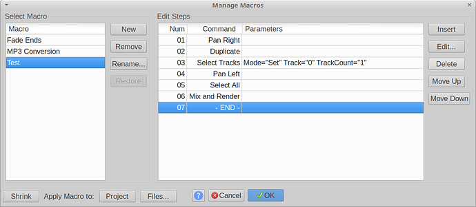

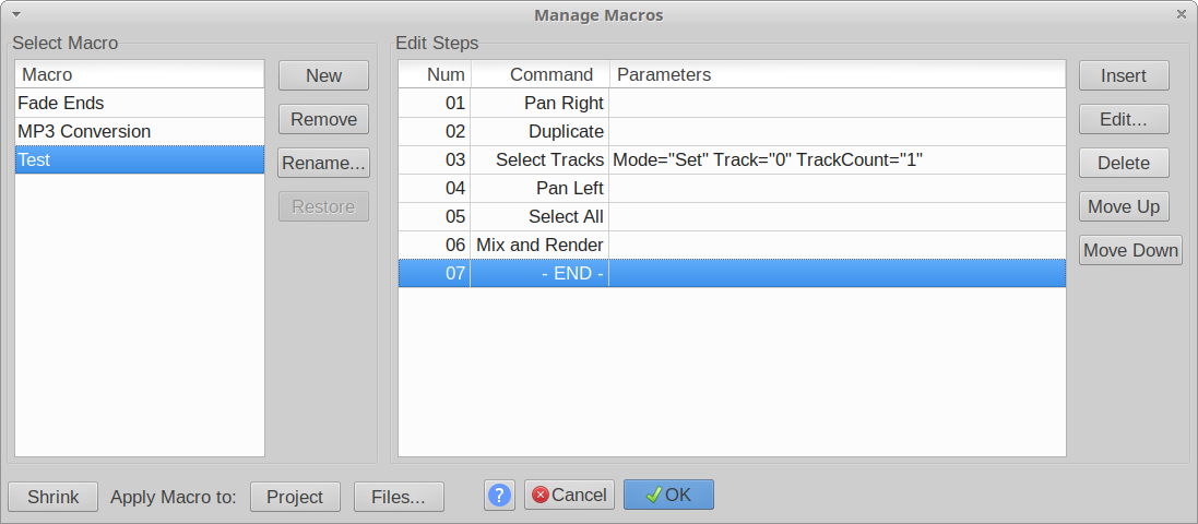

Alternatively, you can duplicate the mono track, pan one track left and the other track right, then mix and render.
(This way is slightly longer, but useful if you need to apply different effects to each channel).
I am going to take what you have shown me and apply it.
I appreciate the help.
