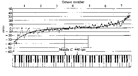

Have you noticed the “interference beats” between a “perfectly tuned” A and an E ? or that a well tuned piano is slightly sharper at the top (high) end of the scale than the low end?
This image is from a book about piano tuning and illustrates “a plot of actual measurements of a piano tuned by a skilled tuner, along with a curve resulting from the average of many such measurements:”
Notice how the top C is about a semitone sharper than the bottom C. This is called “stretching” and is required on (real) pianos to prevent “partials” from clashing,
