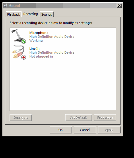

On that you are accidentally recording from the computer’s built-in microphone which picks up the sound of the hard-drive clicking.
You can disable the internal mic in Windows recording devices …
Make sure the USB device [u]is[/u] enabled in Windows recording devices,
and selected as the recording device in Audacity preferences.

there’s no Fast Track mike to select
Where did you do that? You have to enable the microphone in Windows (and see the little sound meter jumping) and then, after that is working, open Audacity and look for it there. If you launch Audacity before you plug the microphone in or Windows recognizes it, Audacity won’t see it.

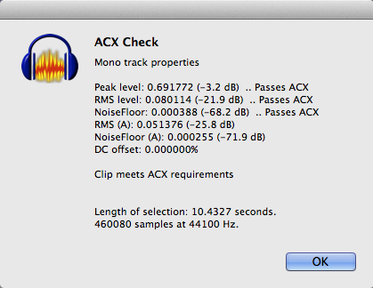

Buried in there is ACX-Check which is a simple, one-pass tool that will tell you what you passed and what you didn’t and by how much.
This is a little Olympus hand-held sound recorder in my quiet third bedroom.
Note the loudness of the background noise in the lead-in.
See sentence 2/3 down.
