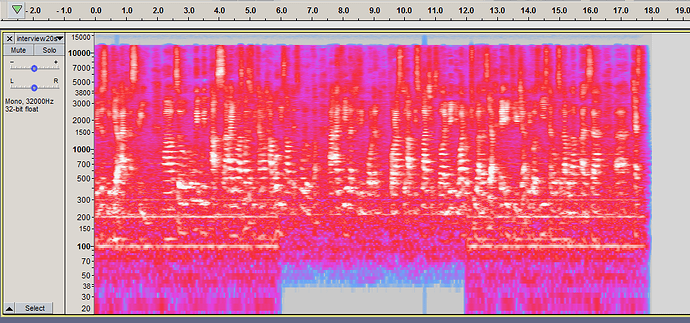

I have recently recorded an interview that I am thinking to use in my podcast because it sounds quite interesting. The problem is that I was recording it in a shop in a room with several big wine fridges/displays. As a result, there is strong background noise. I tried to remove it using Noise Reduction but if I remove it completely the voices are quite distorted and if I keep the voices reasonable the background noise is low but quite annoying. I wonder if there is a semi-manual way to reduce the noise to a minimum without distorting the voices?
If fridge noise is constant it may be possible to notch it out without conspicuously distorting the voices.
Look for bold constant horizontal lines on the spectrogram display … https ://manual.audacityteam.org/man/spectral_selection.html#example

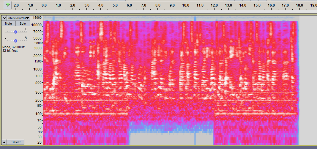

My spectrogram looks like this.

Thank you for the sound track, but it’s missing the one thing we need for good noise reduction. He never shuts up. We need a good fraction of a second with refrigerator only and no voice or gasping.
Note at 7 seconds, 9 seconds, and about 17 seconds, he gasps for breath between words. Also note at about 13 seconds, the interviewer interrupts the guest “Yeah.” If he does that throughout the interview, then this will be an uphill battle with them stepping on each other’s words.

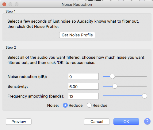

Noise reduction works in two parts. Drag-select a small portion of clean noise with no performer or desirable sound. Effect > Noise Reduction > Profile. That lets Noise Reduction “sniff” the noise like a dog getting the scent. Then you select the whole performance and run Noise Reduction again with the desired correction values set. Sometimes you can run Noise Reduction more than once.

This is a panel with the Noise Reduction settings.

Filter Curve is the Audacity version of the standard 100z rumble filter that appears on every field sound mixer.

100Hz is the worst offender …
I saw that. That and 200Hz vanished in the Hum Remover - European step. Some of it also goes away in Low Rolloff.
