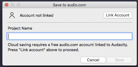

Audacity should be restricted to work on your local drive. No External Drives, Home Network, Internet, Cloud or any other non-internal drives. The sole exception is the audio.com cloud drives and then only if you’re using the 3.6.x Audacity versions or later.

That was the story up until the Audacity cloud drives from Audio.com.
These services are married to your local Audacity and everybody knows what’s going on. That’s not a license to use anybody else’s cloud drives. You are urged to try this service on a non-critical show before you commit.
I don’t use that service, but from fuzzy memory, you get some free storage and if you exceed that, it starts costing money. Something else to check before you commit.
