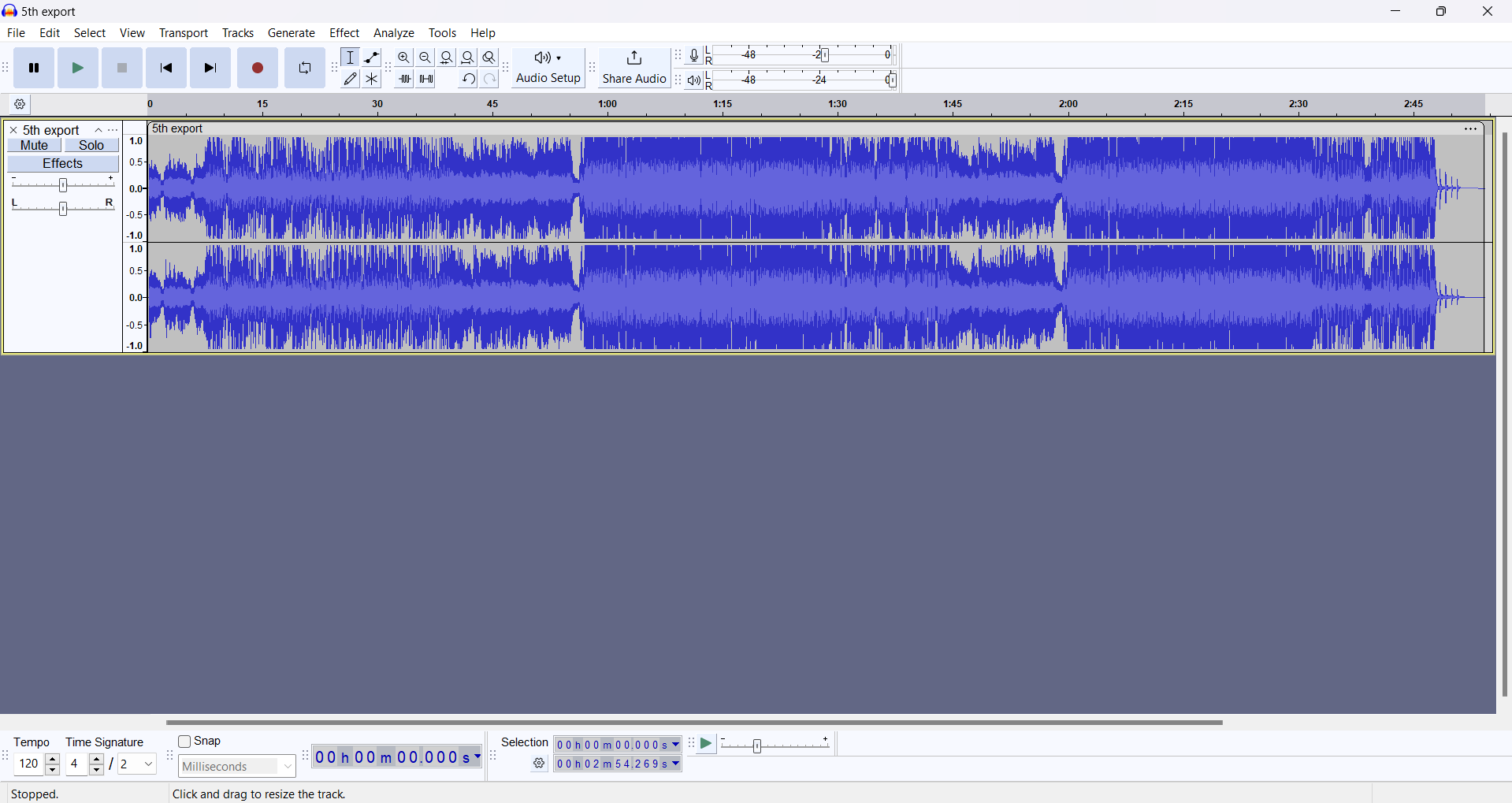

Every time I export a track as a FLAC file, the waveform appears “cut” at the top and bottom. After some testing, I discovered that the cut consistently measures around -0.1 dB when applying the “Amplify” effect. This happens every single time I export to FLAC, regardless of how the waveform looks before exporting, the exported file always ends up slightly “silenced” by about -0.1 dB.

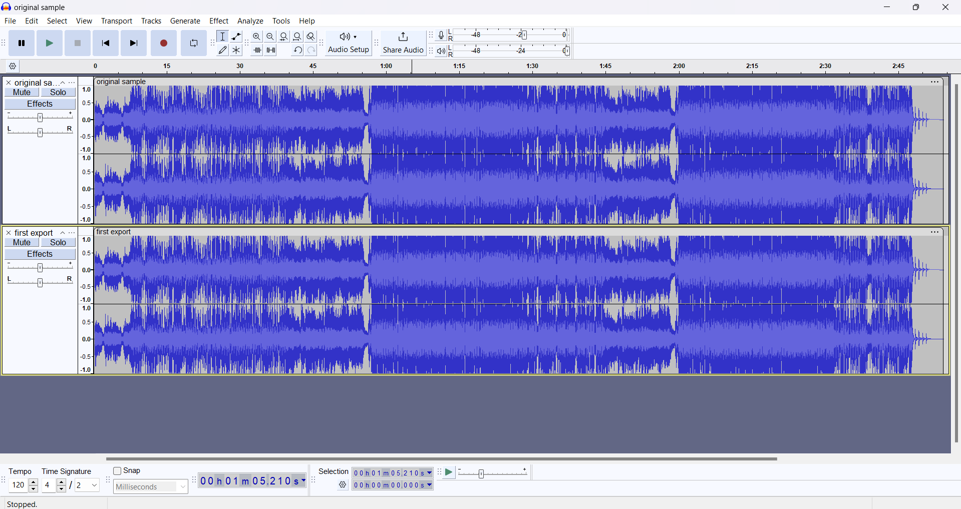

In the attached images, the first waveform shows the original file. The second shows what it looks like after the first export. The second image is the result after exporting that same file again, repeating the export process five times in total, the waveform ends up quieter by around -0.5 dB overall.
Why does this happen, and is there any way to prevent it?
