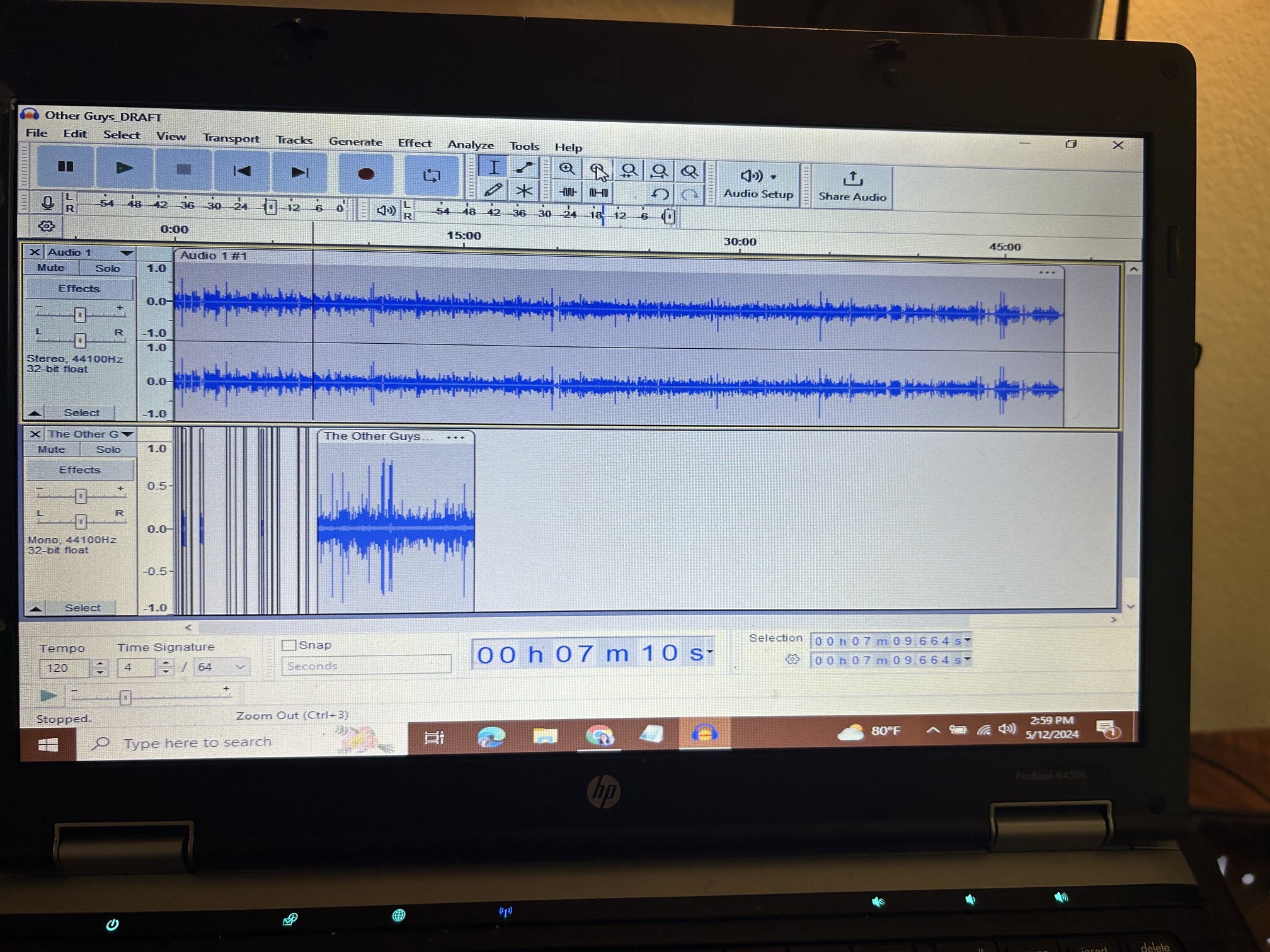

I have attached an image of both the recording length (full is mine on top) and hers (condensed) on the bottom.

If you mute the top track and play the bottom track as it is shown… It surely must play like chipmunks…??
… very fast and high pitched…??? … the bottom is a collection of clips…
Was the recording done with Audacity or on some other device…?
It was recorded at a normal rate as far as I know. The audio sounds good; not fast like the chipmunks or slow. It was recorded using audacity

I reckon it has been resampled or bitrate changed in some way.
Take a copy of track 2 and open it on its own in Audacity. Then Effects…Pitch and Tempo…Change Speed and Pitch…Selection Length…current Length will be 16 minutes and New length will be 50 minutes…click apply. Track will be lengthened from 16 to 50 and pitch will have dropped by same ratio. 3.125.
Then Pitch and Tempo…Change Pitch…Frequency…Percent Change …312.5 %.
Then Select track…Edit…Audio Clips…Join… all clips will be joined.
May not fix it but may let you see what happened…??
