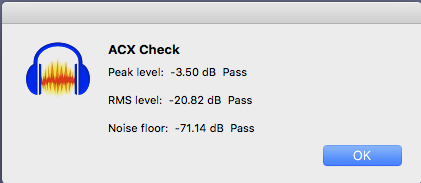

A recording on it - in a bedroom, the Edirol is battery powered, with record mode as WAV 24 bit (whatever that may imply)- gives a WAV file as shown below. (Roland3). Well, actually I had to load the file into audacity and cut out a bit of it, then export it as WAV again to get it small enough to be an attachment, if that makes a difference.
After doing an “audiobook mastering” in the suggested way, It passes Peak level and RMS level but fails Noise Floor (-58.49 Db). A section of this is Roland4.wav
Now, after a noise reduction effect based on a few seconds silence at the start, it passes Noise Floor (-61.43). The Noise Reduction set at 3Db, sensitivity 2, and smoothing bands 3 - the latter two values chosen completely at random, as I have no idea what I am doing. A portion of this is Roland5.wav
So- well, does this sound OK? It barely passes the Sound floor, should I alter it more? Differently? Give Up? Sorry to be vague, looking for feedback on whether I would be able to produce to ACX quality with this equipment.
