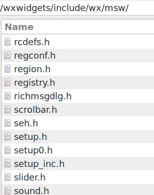

Before building from Git sources under Windows, you need to copy the file include/wx/msw.setup0.h to included/wx/msw/setup.h. At first, I was totally lost. Where do I get this setup0.h file? At last, I found the file from the wxwidgets I cloned from GitHub using git-bash and recurse-submodules. Please remember this is not the wxwidgets I installed in my computer. Is this the right file? I do not know for sure. I copied this file to the wxWidgets3.1.1 I installed using the execution file I downloaded. I did see a setup.h file in include/wx/msw in the wxwidget3.1.1 I installed using the execution file. What I did was to file setup.h to setupOLD. Then I copied the setup0.h to the same location and renamed it to setup.h. Did I do it right?

The first link ----https://github.com/audacity/wxWidgets/blob/v3.1.1/README-GIT.md. When you open up the link, you will see “copy setup0.h” to setup.h. This setup.h file is in the Include folder of wxWidgets3.1.1. I think the author of this just copied a similar statement from the wxWidgets website. It does not tell you where to get setup0.h. I was so frustrated and I happened to brows the wxWidgets website and found the same statement without any elaboration. What is it for? Only the author and the wxWidgets people know. If you only want to compile Audacity for use with ASIO in Windows 10 . please ignore this instruction. Even in the second link, the instructions are not pertinent. You can ignore it also. You do need to set the environment variable WXWIN correctly though.
I don’t understand what you are saying. The only things I see in include folder (“wxWidgets/include/”) are “msvc/wx” and “wx”. I’m looking here: https://github.com/audacity/wxWidgets/tree/audacity-fixes-3.1.1/include
However, I do see that there is a file called “setup.h” in “/include/msvc/wx/” (https://github.com/audacity/wxWidgets/tree/audacity-fixes-3.1.1/include/msvc/wx). Perhaps that is what confused you?
Here’s the instructions that you are referring to, with links added to the text:
In other words, rename setup0.h to setup.h (but the wxWidgets developers recommend copying rather than renaming, so that you still have the original setup0.h file)
You should end up with this (where “steup.h” is a copy of “setup0.h” of the same folder):
