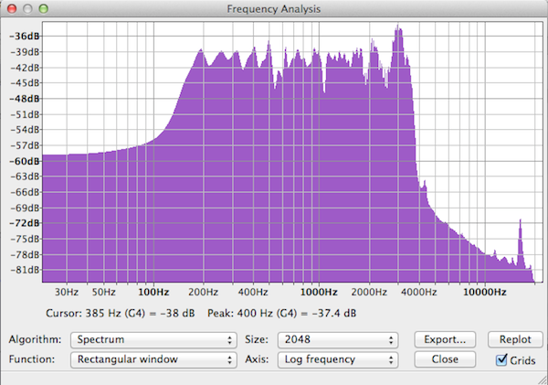

I’ve tried the chirp method for the moment, and indeed it does cutoff at the upper frequencies - far higher than probably needed for telephony purposes. I re-ran the process from 1-5000Hz over 30 seconds, captured the playback, and did a frequency analysis of the returned signal:
Now, in fairness, this is not a good recording of the playback, but it serves for discussion. (More on the capture method below.)
So, taking the graph above, is there a way to invert it and translate it to EQ values to create a flat-top like the input file? Or is it a matter of doing it visually with the EQ sliders (which is OK too).
And before I do that…is there a way for Audacity to record from the laptop’s speaker channel? The above was done using the built-in microphone, which of course has its own response curve and won’t be accurate, as do the speakers. (Ideally, I’ll find a way to rip the playback file directly in digital format. In this case the playback is happening via a flash-based player, so some under-the-hood nerding will be required. I’m on MacOS 10.9.5 with Audacity 2.0.6)

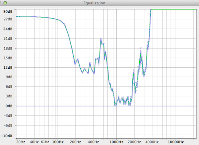

So, curiously, here is the EQ curve, and below it is a subset of the imported XML file. The interesting point is that the EQ curve does not look like the imported XML values - most of the first several frequencies are supposed to adjust upward by 27dB, but are only 21dB on the curve, and the net effect appears to be only 10dB. Any insight there?
Aside from not completely flattening out the mid-tones, it seems like the EQ has an upper limit of perhaps +20dB. But that still doesn’t explain why +20dB on the curve only has a ~+10dB effect on the actual recording.

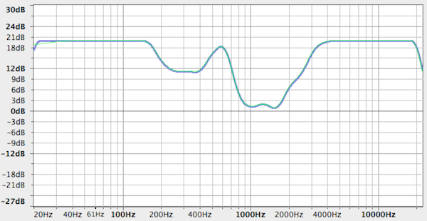

You’ve been bitten by a bug in Audacity.
The Equalization effect has two “modes”. In the “Graphic EQ” mode (the view with sliders), the gain range is +/- 20 dB. In the “Draw Curves” mode, you can go far beyond that range (not sure “how far” without checking, but certainly “far”). The “bug” is that if you select the EQ curve while in “Graphic EQ” mode, the values that you calculated will be limited to +/- 20 dB, and those limited values will remain even when you switch to “Draw Curves”.
The workaround is to open the Equalization effect, ensure that it is “Draw Curves” mode first, and then select your custom curve.

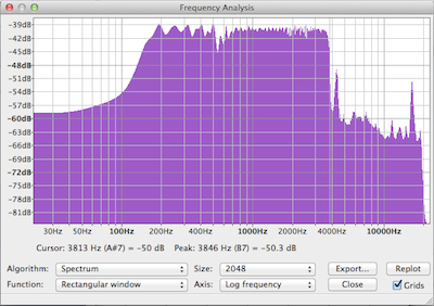

Ah. That has made a significant difference. Still some interesting things to explore, but much closer. This is the same EQ Profile, reloaded per your instructions and applied against the same file as above. Much sharper profile, and much closer to the plateau I was expecting. Still some gaps to investigate.
