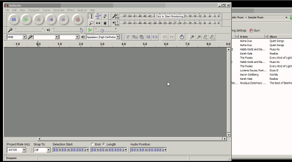

I read this thread, but I’m confused (of course). I can’t find the “time shift” tool on my menu. I also don’t know what I’m supposed to be importing.
Here’s what I want to do: concatenate a spoken intro, a song, another spoken intro, and another song into a single file. The songs are in 4-part harmony (I’m singing all 4 parts). So do I make a file for the first intro, save that, make a separate file for the song, with 4 tracks, save it, make a file for the second intro, save it, and make a separate file for the second song? I would end up with 4 files. Do I then load all of them into Audacity and use the “end-to-end” concatenation (which I also can’t find) to put them together (using appropriate file names so they end up in the correct order)?
