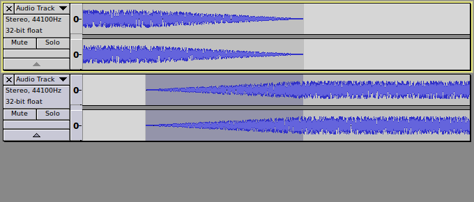

In Audacity 1.3.12 you can import both of the files - each will appear on it’s own track. If you keep the files on their own tracks then you can cross-fade from one to the other which will produce a smooth, click free edit.
This is a cross-fade:
You can move sections of a track by splitting the track (Edit menu), then using the “Time Shift” tool (double headed arrow <–>) to slide sections left/right along their track.
