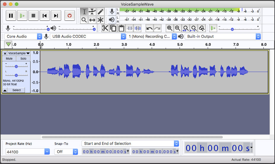

The general recommended voice recording level is peaks about -6dB or half-way on the blue waves.
The bouncing sound meter starts changing color right about there, going from green toward yellow. If you hit red, you’ve got clipping damage.
Also remember the digital system isn’t insanely noisy like tape. 16-bit sound range is 0dB (clipping) down to -96dB! You can slide sound quieter and louder anywhere in that range without damage. Don’t run out on either end, and don’t overload your analog system. Watch those red PEAK lights.
You can certainly produce a robust, dense sound for a show, but it’s strongly recommended you produce a clean recording, save it for protection, and then get there with effects. We can go from a clean recording to anything else, once you produce distortion right at the top, you’re stuck.
