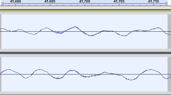

I think I may have found at least one location where the sound occurs. (See attached jpg)
Is there a way I can clean up this area to remove the noise?
I see some “wiggles” that might be noise, but I don’t see anything related to cutting/splicing.
