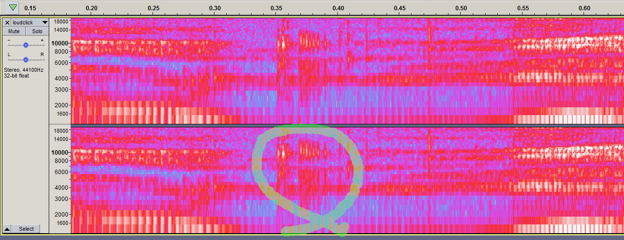

loud clicks, which sometimes appear and the declick tool does not manage to remove them sufficiently
Are these mouth clicks? If not, what else could they be?

Splashy “loudclick” is actually series of clicks mainly around 10kHz, & only ~2ms apart.
Their closeness is why Paul-L’s de-clicker will not detect then on default settings.

On a whim, I took Trebor’s suggestion and ran the de-clicker on loudclick changing the step size from 5ms to 2ms. To my ears, the “character” has been essentially eliminated. I do not know the downside of this change.

Could you please post your full settings for declick?
I changed the step size to 2ms as you suggested but this did not affect the click at all
