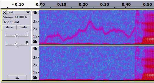

It’s not “distortion”. There’s quite a lot of “hiss” noise, plus there’s a peculiar “squeaking” sound.
It is visible in the first half second of that clip (before you start talking) if you set the track to Spectrum View
It’s interference of some sort and attempting to remove it is likely to cause a lot of damage to the sound that you want to keep.

The “squiggle” is only in the left channel which means that interference from an outside source is unlikely to be the cause - it’s most likely just a poor sound card.
If you split the track (click on the track name and select “Spit to mono” then delete the left track, the noise removal effect will work better on the remaining (previously right channel) mono track. (though I’d still recommend upgrading the hardware as a better long term solution).
