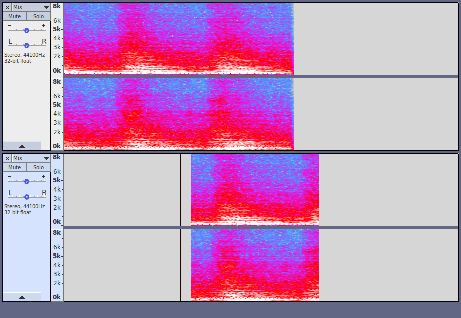

As the first chord repeats almost identically several times at the beginning, I decided to replace the first “stab” with the second occurrence, so that I could avoid the problematic fade-in.
In this screenshot, the selected area is approximately the part that I duplicated (Edit menu > Duplicate) into the second track, and then carefully lined up with the first stab:

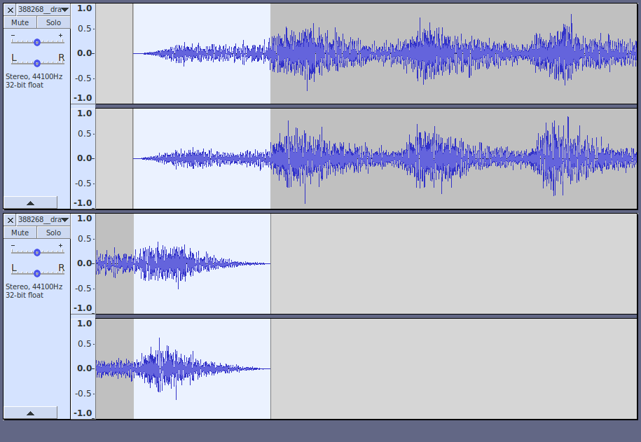

I then trimmed a bit off the end of the second track, and crossfaded it with the first track, using the “Crossfade Tracks” effect.
Then I trimmed the start of the second track so that it started at exactly the same time as the start of the first track

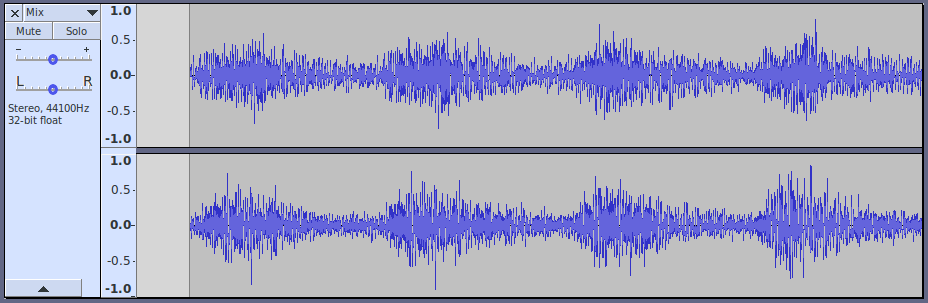

Then “Tracks > Mix > Mix and Render” to mix the two tracks into one:

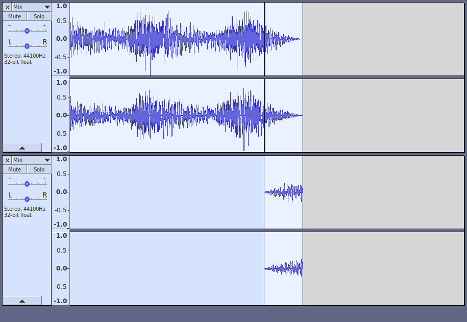

In this case, it was a bit tricky to line up the duplicated 2nd to last stab with the final stab in the first track, so I switched to the track spectrogram view so I could see the accent more easily.

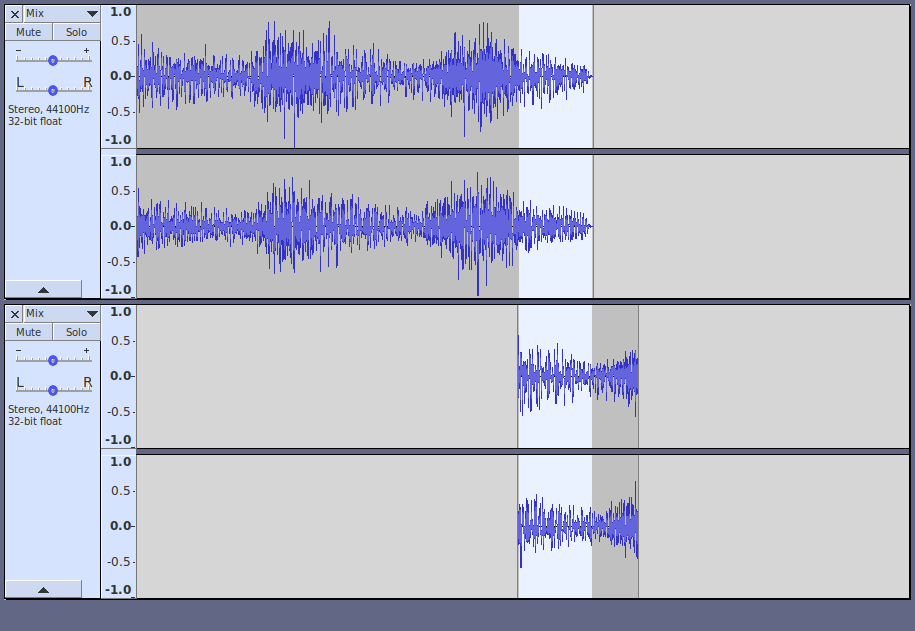

Trimming and selecting for the crossfade

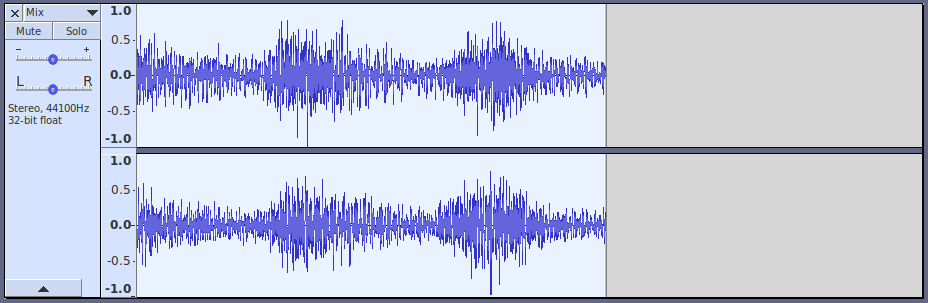

Final trim:
and final mix:
