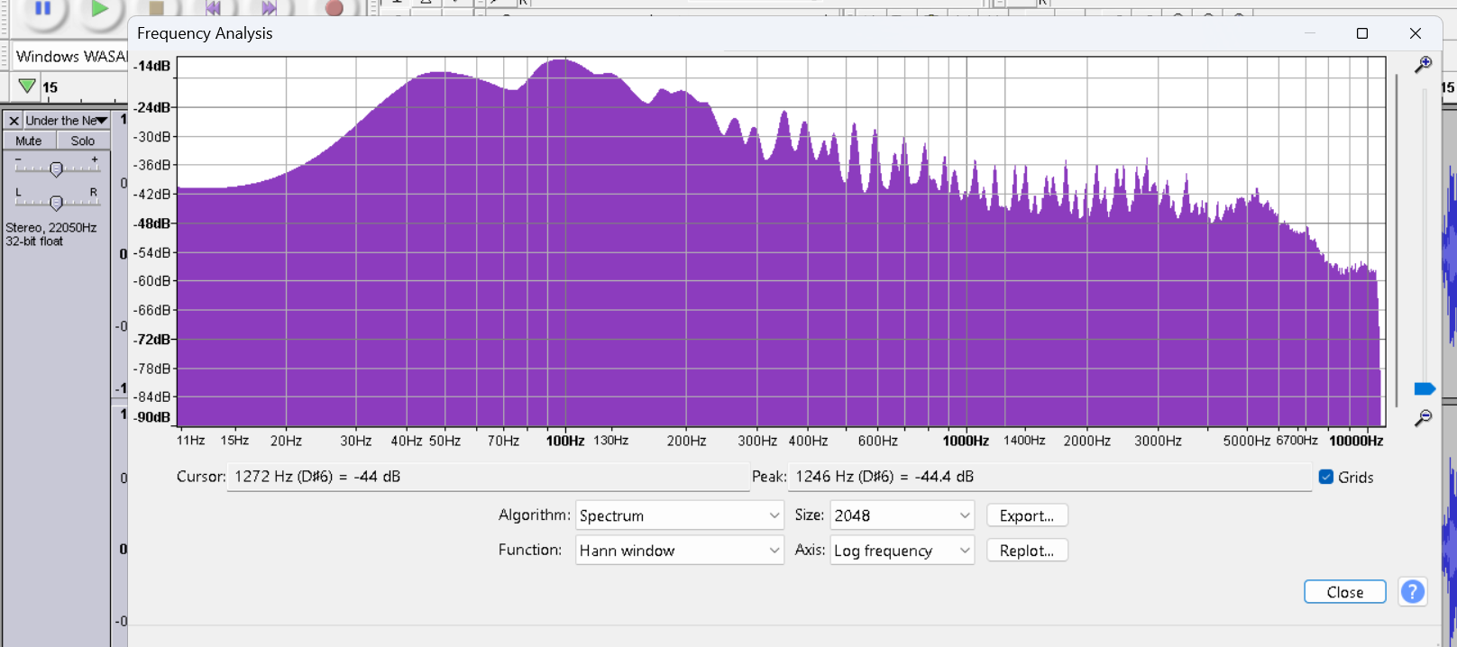

Bonjour,
Le spectre affiche une bande de fréquence de 20 a 20000 Herz
Je souhaite afficher le spectre sur une bande spectrale plus étroite de 80Hz jusque 10000 hz Si quelqu’un peut m’aider, je serai très reconnaissant !! Merci ericF
Bonjour,
many Thanks Trebor !
I do not like to use Spectrograms, but Spectrum using: analyze/plot Spectrum/frequency analyze
I would like to reduce the ploted frequency from 80 to 10000Hz in this window.
Sorry, my english is basic… Eric
There are two free plugins which do that which work in Audcaity3 …
https://www.voxengo.com/product/span/ & https://www.tokyodawn.net/tdr-prism/
Alternatively, without plugins, you could resample the audio to 22050Hz, then the range is 11Hz-11000Hz …
A great Thanks, Trebor, your solution is fine, I resampled the audio at 22050Hz.
its perfect for my need !!!
