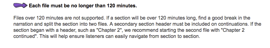

The 120 minute rule does mention sub-chapters, but those are just fancy labels for real chapters.

I think they want you to state the chapter followed by the subheading, pause, and then read. So the chapter will be read again and again depending on how many subs you have.
