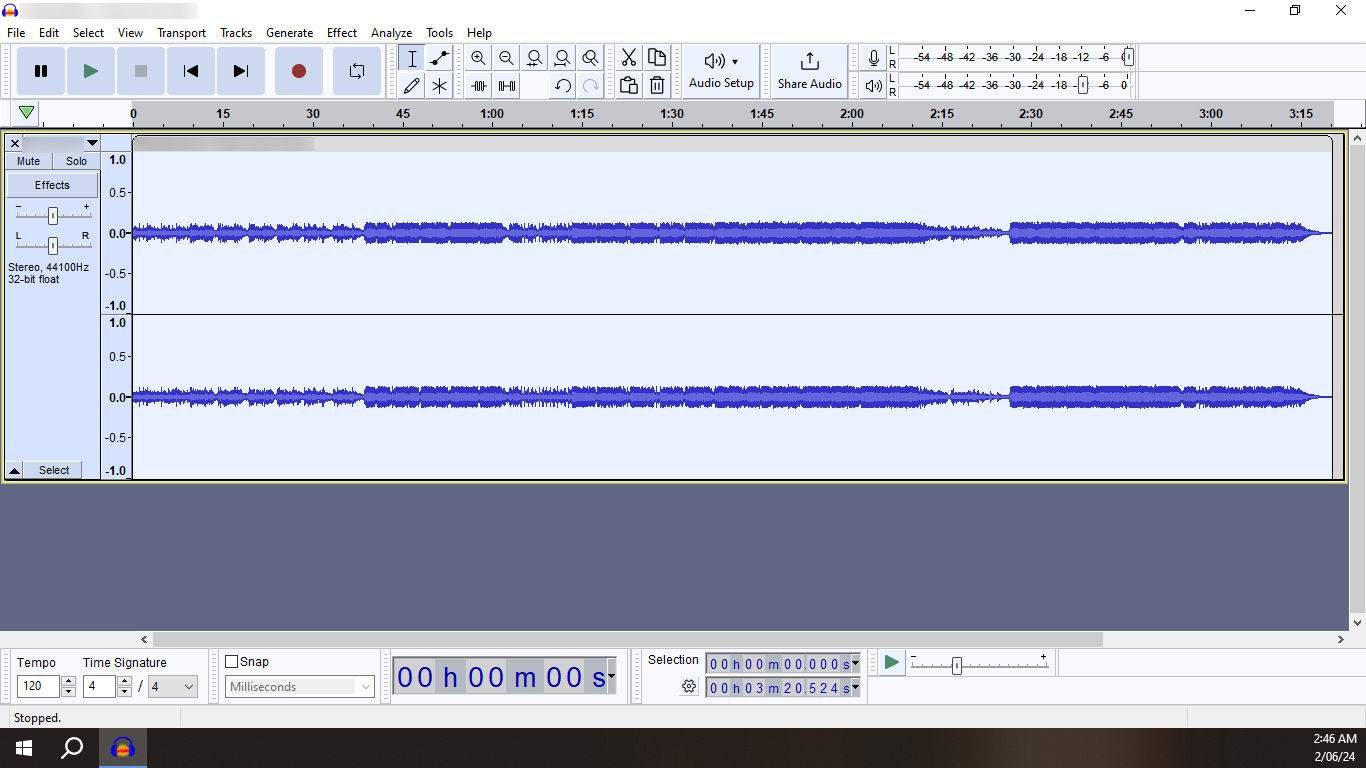

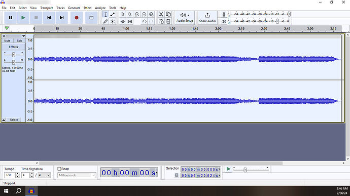

To give you a visual representation of what DVDdoug is saying;
Your files probably look like this; probably indicating they were recorded at low volume;

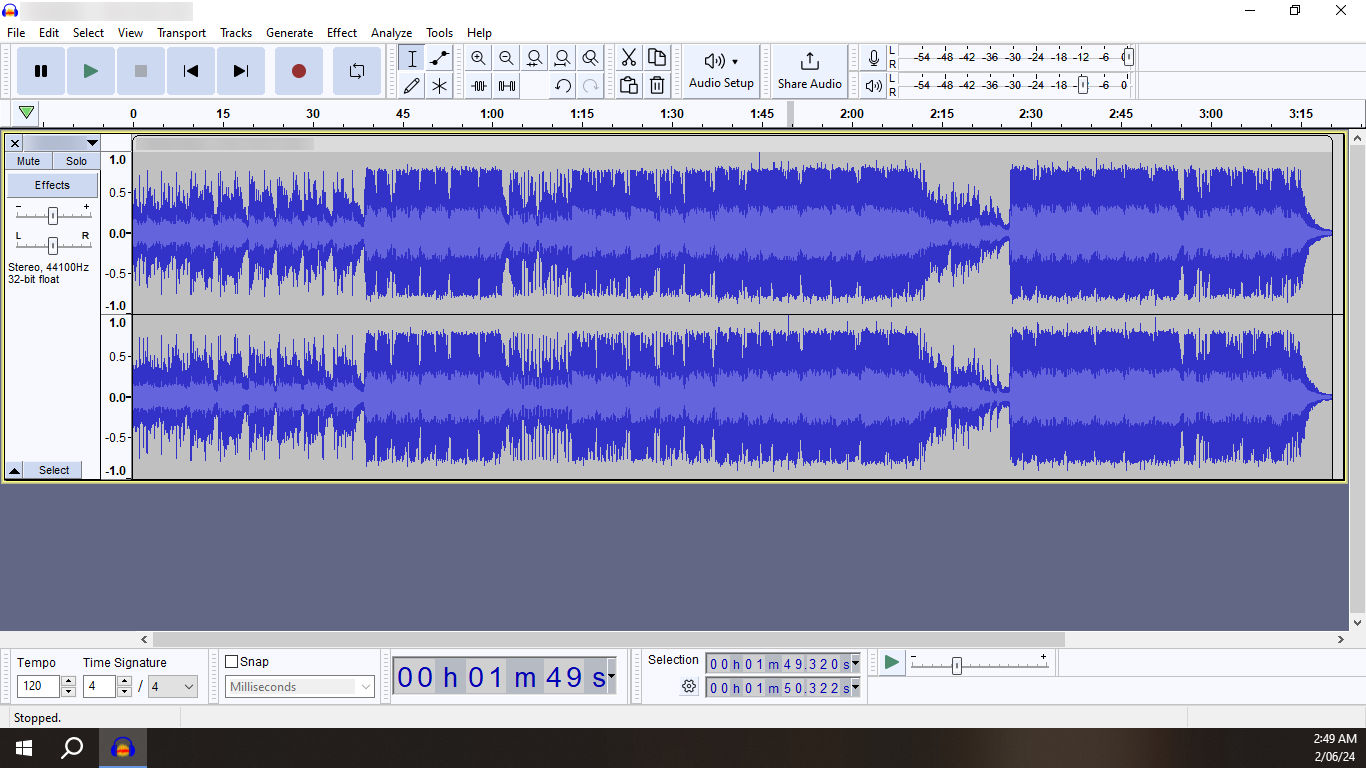

Using Volume or Normalize effect on it at default values would return something like this;

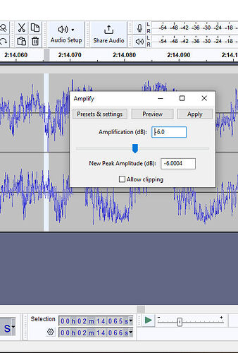

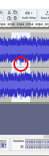

Sometimes you will get files with a peak preventing full volume amplification as such;
Simply zoom in, select it and give volume a negative value to knock it down some and then re-amplify at default values to get full volume;
