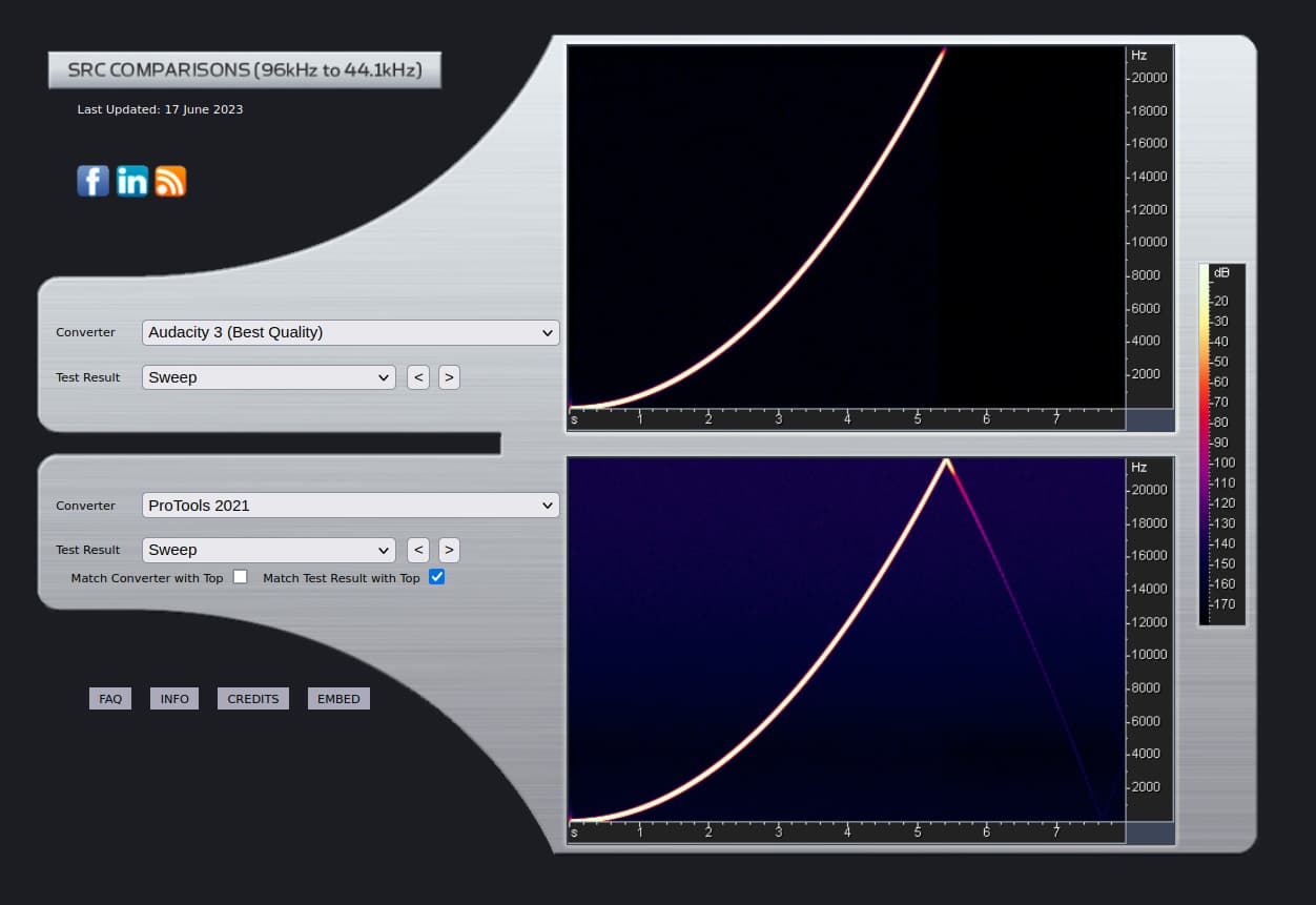

In this image we can see Audacity’s (soxr) resampling stops a little bit short of the Nyquist frequency (the line does not go quite to the top, whereas the ProTools 2021 filter allows a little aliasing distortion (the line “bounces back” from the Nyquist frequency. The dark blue (rather than black) background to the ProTools version is noise, which is most likely due to 24-bit samples compared to Audacity’s 32-bit samples.
Note that these images are extremely discerning and shows up the tiniest deviations from perfection. The ProTools plot is actually very good, though not quite as “ideal” as Audacity’s resampling.
(Images from: https://src.infinitewave.ca/)
