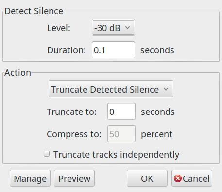

An alternative approach, which could be used in conjunction with Change Tempo, is to trim down the gaps between words.
Here’s an example using these settings:
and the resulting audio:
