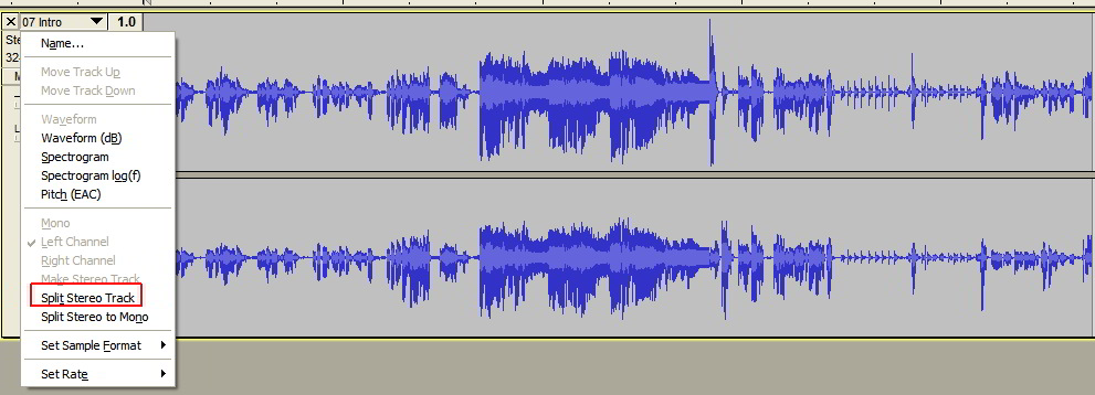

To split the track see attached images. Click the down arrow and select “Split stereo track.” Once it’s split, select the track you want to adjust by clicking the mouse in the empty space shown in picture. You can then amplify it up or down with the Amplify Effect (Effects Menu>Amplify).
When you’re done, click in the empty space below the waveform to remove the selection, then you can rejoin the channels. Click the down arrow again and this time select “Make stereo track.”
If both channels have been normalized to 0 dB (or close to 0 dB), then you should only adjust down because increasing the level will push the peaks over 0 dB which will create distortion (clipping).
