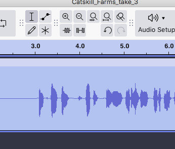

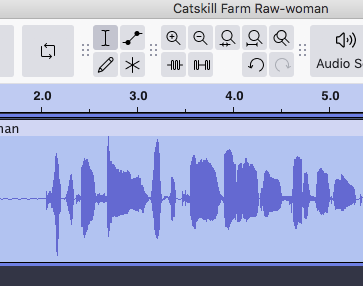

Nope. Here’s two examples. The first one shows a lumpy, fuzzy middle line. That’s normal breathing, mouth noises, background sounds, etc.
UnclippedScreen Shot 2024-08-01 at 5.24.02 PM
The second one shows a thin center line—little or nothing in the middle. That’s you.
Catski Far Rich Eamy…
ClippedScreen Shot 2024-08-01 at 5.25.05 PM
