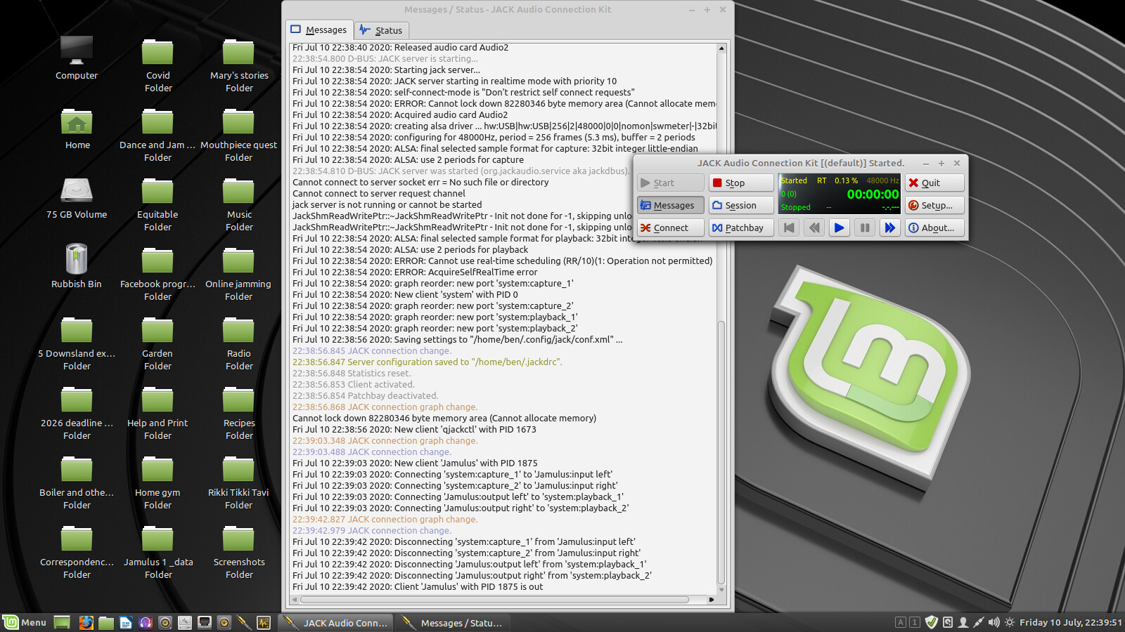

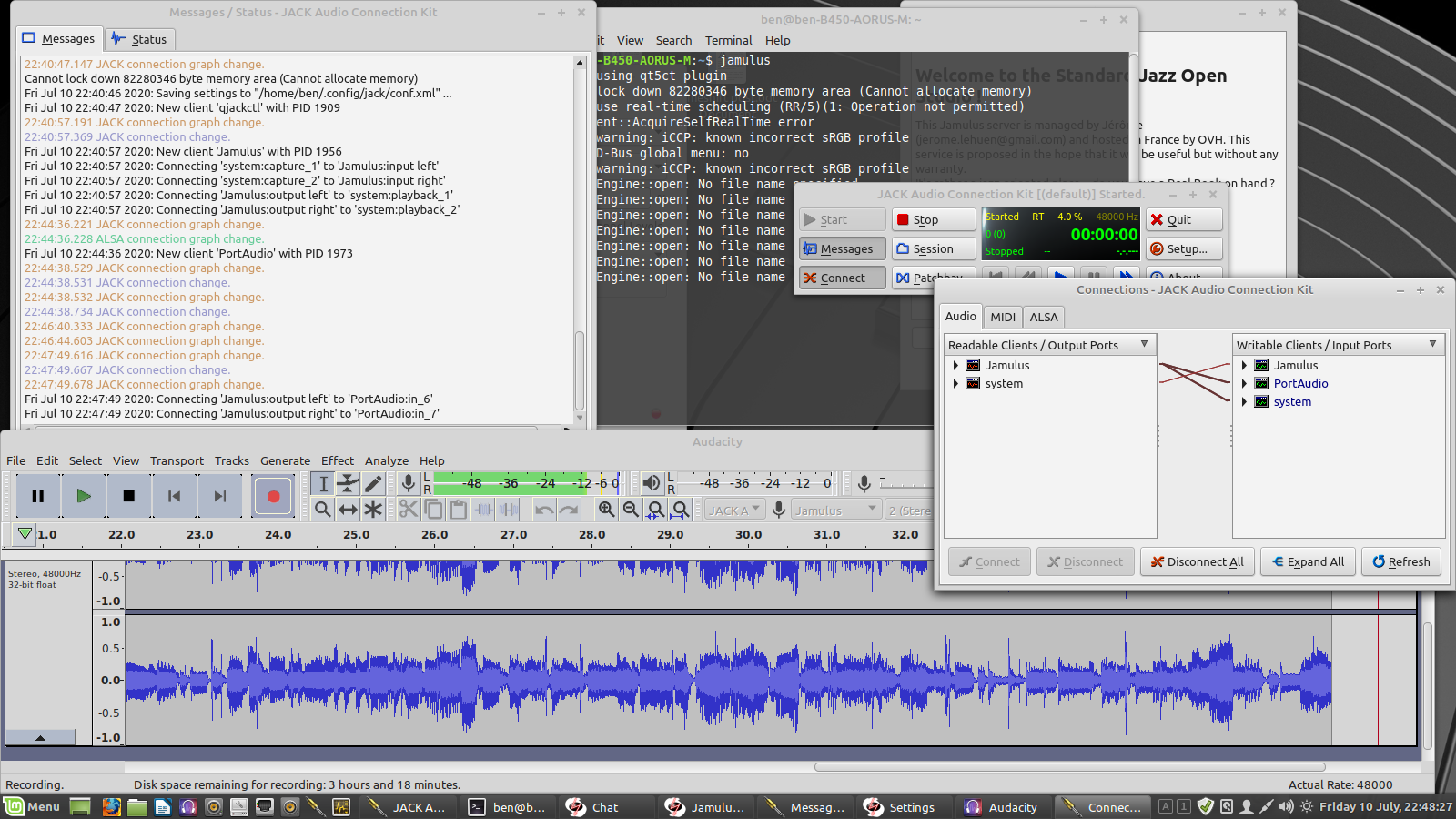

Tonight after getting an “unable to connect” message in the jamulus mixer window, I noticed that I was getting XRUNs.
Once this happens I am unable to stop Jack properly. Sometimes it apparently stops after a long wait, but then it won’t start properly, the windows open but there are no graphics inside. So I have to do a reboot.
Usually iI can connect to servers normally, but once I get a “unable to connect” in the jamulus mixer window then I find I cannot close qjackctl.
I can run Audacity, if I start it after I have connected to a server. If I stop recording but leave it open, then shut everything else, then export the Audacity recording and close Audacity, I can restart everything up normally.
But if I stop Audacity recording, leave qjackctl and jamulus open while I export the recording, at the moment I close Audacity, all sound from the jamulus server stops, and although if I disconnect and remake connections in the qjack connections window, I can connect to a server; all sound is distorted, I may even be affecting what other players can hear, and I have to close down, and that means qjack will have hung again and I have to restart. The distortion probably has a name to it, it sounds like very short segments of sound are repeated or echo very quickly, like 10 times per second.
So Audacity is something to do with it but not the only problem
Screenshots attached of one good stop of jack, but I’m afraid I lost count of what was happening when I took the others
