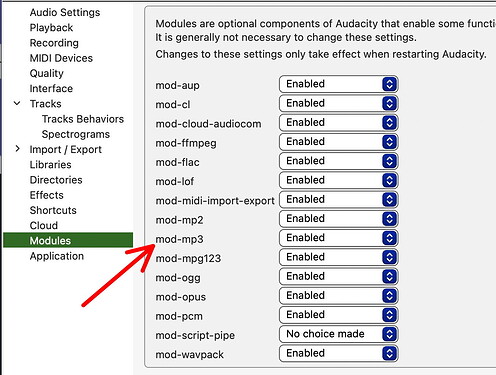

I did not see any indication about the version of Audacity you use. Earlier versions (I don’t remember until which version number) could not export mp3 - no idea whether they could import it? Is the mod-mp3 module enabled in the preferences (see image)? If not, enable it (and also all other modules).

Good evening . The wave file works fine. unfortunately i cant find the Modules you are directing me to the version i have is 3.7.5 i can change what i have to a .wav file but it would be nice to be able to stay using MP3
I have found where to look for the modules and it is set at enabled so i disabled it shut Audacity reopened it and changed it to enabled shut it down reopened and it didn’t work. looking at recent files none of the MP3 files i have edited in Audacity will now open :frowning:

It’s NOT the modules. I disabled mod-mp3 (and just for good measure mod-MP2 and mod-MP123). I could still open MP3s but I couldn’t export as MP3.
