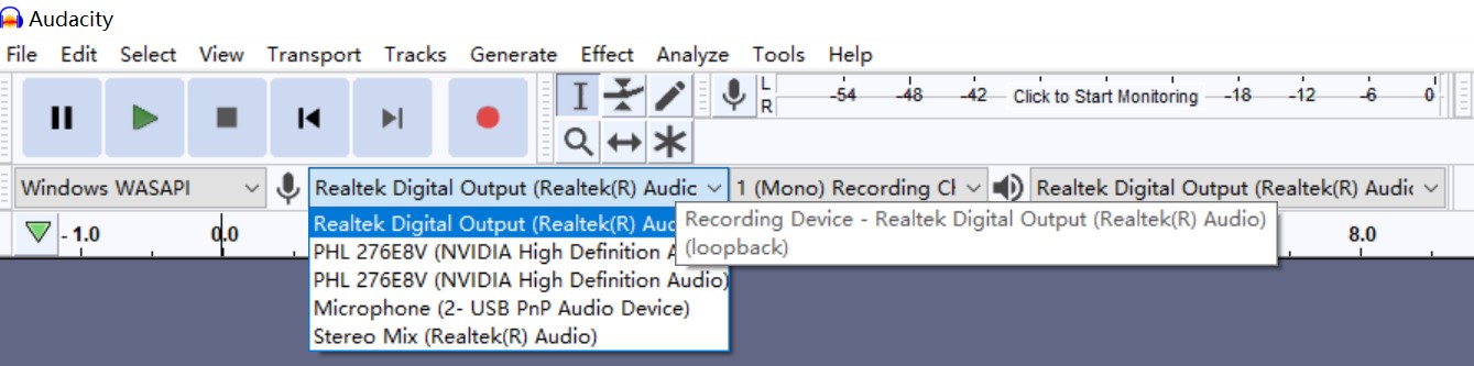

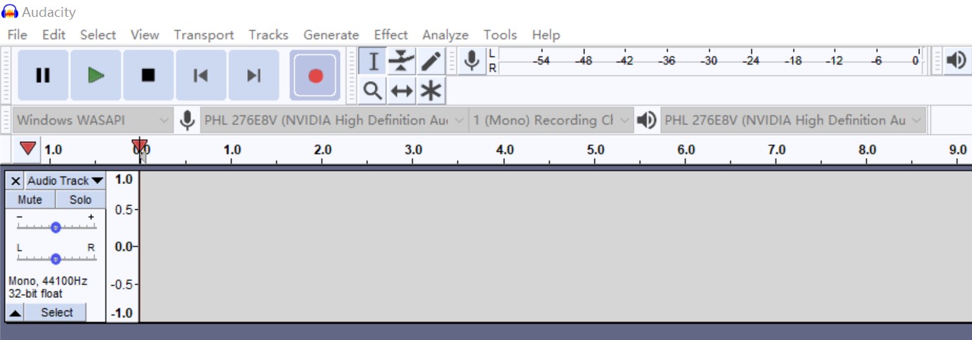

I am trying to record some audio that comes out of my computer but the cursor stuck at 0:00, as shown in the attached figure.
The output device is selected to be a monitor because my monitor do has an audio output, and my speaker is indeed plugged to the it. I’ve checked the online manual and most of the similar posts here but still can’t fix it. Overdub unchecked, sound activated recording unchecked as well, it just doesn’t work.
Yes, like I said in the main post, this is the monitor I am using and there’s an audio output on it. BTW I’ve tried using Stereo Mix but it did not work. I could start recording with Stereo Mix enabled and selected but it did not pick any signals.

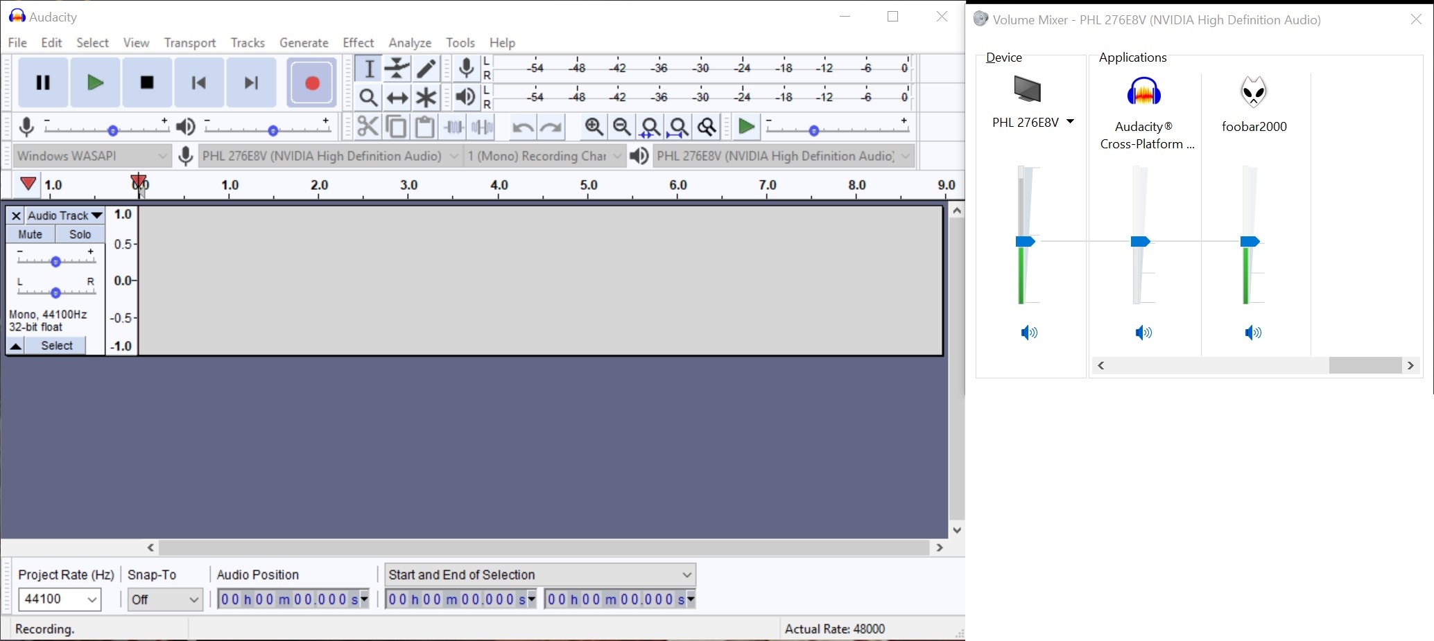

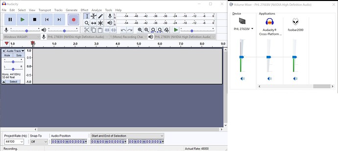

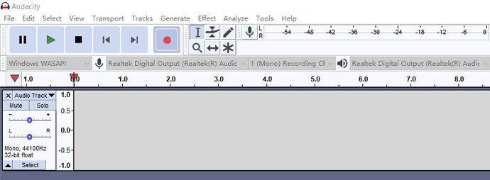

Hi Steve, I tried that built in sound card and it didn’t help. Check the screenshot right above your previous reply please. Is there anything wrong with my settings?
Alright I finally made it work by setting the sound card to be my default player instead of my monitor. However my speaker is connected to my monitor so I can’t hear what is being played (it can be recorded though). Is there anyway to make it work with the monitor?
