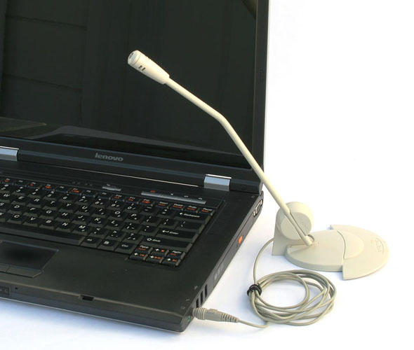

Neither one should work. Computer Mic-In is expecting an actual computer microphone such as this.
Most Mic-In connections aren’t stereo and most of them will overload when you try to apply a high-volume stereo connection.
