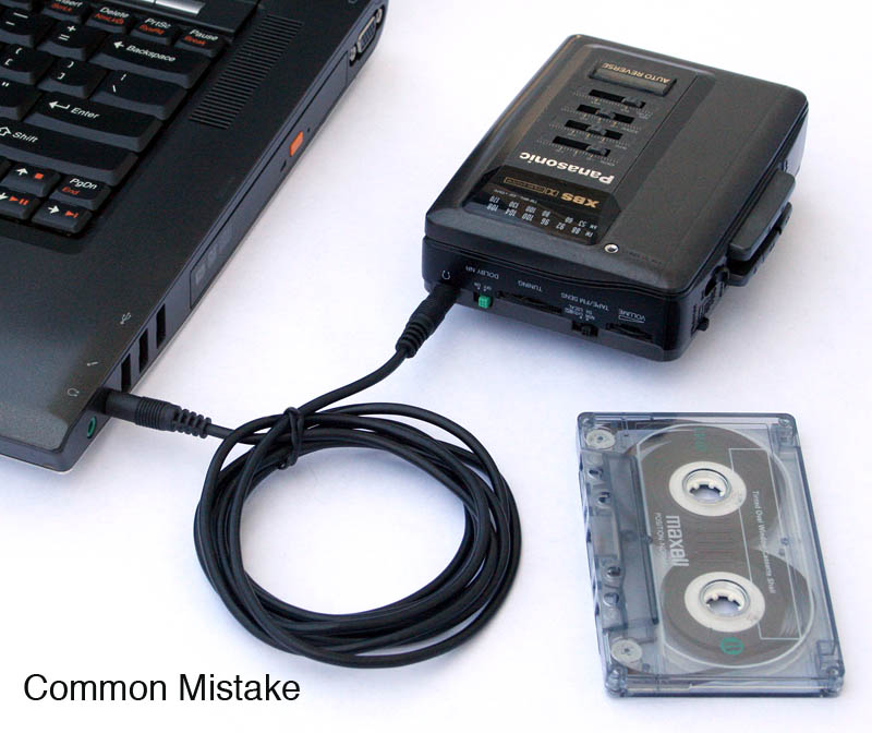

On to the computer. That probably isn’t stereo either. Unless the laptop connection is one of three and/or is blue, you plugged the cable into the pink mono microphone connection.
The above machine only has two connections.
Not only is the pink connection mono, but it’s super sensitive and easily overloaded, so it would distort even if you could get it to work. I can’t tell you how to connect to the Mic-In of your machine. I’m not a Windows elf.
So after you get access to a stereo machine (like in the illustration), you could connect it to a stereo to USB adapter such as the Behringer UCA-202 and plug that into your laptop. Pretend that thing on the right is your stereo cassette player instead of a stereo sound mixer.

So, Audacity is not showing you the External Microphone input, assuming it works. To correct that, do Transport > Rescan Audio Devices from the Audacity menu bar, or restart Audacity.
If you still do not see External Microphone in Audacity, open Windows Sound then follow the instructions in that link to show and enable the External Microphone.
As Koz said, you will also (probably) need a USB interface to provide you with a proper stereo line-in. Sometimes the External Microphone port on laptops is a “compatible” input that can accept stronger stereo signals, but such inputs are usually not as good quality as a proper stereo line-in that is only meant for strong stereo signals.
