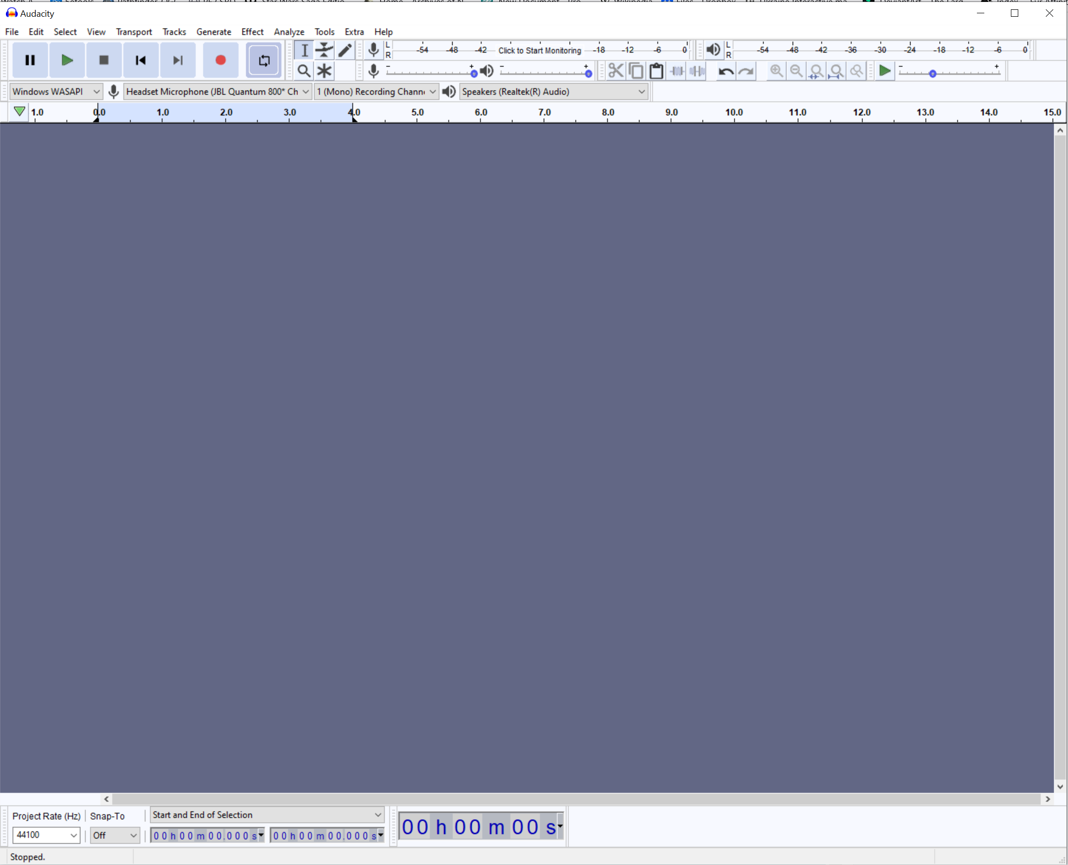

Hear is the file, and an image of the player. Just encase that helps.

So, you seem to have your choice of the following loopback devices:
U32R59x (NVIDIA High Definition Audio) (loopback)
Headset Earphone (JBL Quantum 800* Chat) (loopback)
Speakers (JBL Quantum 800* Game) (loopback)
Speakers (Realtek(R) Audio) (loopback)
Headphones (CORSAIR ST100 Headset Output) (loopback)
Be sure you have the correct loopback device selected.
Ok, i see what you meant by loopback device. as i was thinking it was in the Speaker section of audacity not in the mic.
That said, When i attempt to use JBL Quantum 800 game, Realtek(R) Audio, CORSAIR ST100 Headset Output I get, and error -9996 with the details of.

If i use NVIDIA High Definition Audio, BL Quantum 800* Chat it dose not give me the error. But the bar dose not start recording anything.
Ok, i was messing with it and somehow got it to work. I made it go on directsound, with Realtek(R) Audio on both both stereo mix and speakers. i can’t get it to work on my headset. but this seemed to fix the issue. as it is recording sounds normally.
